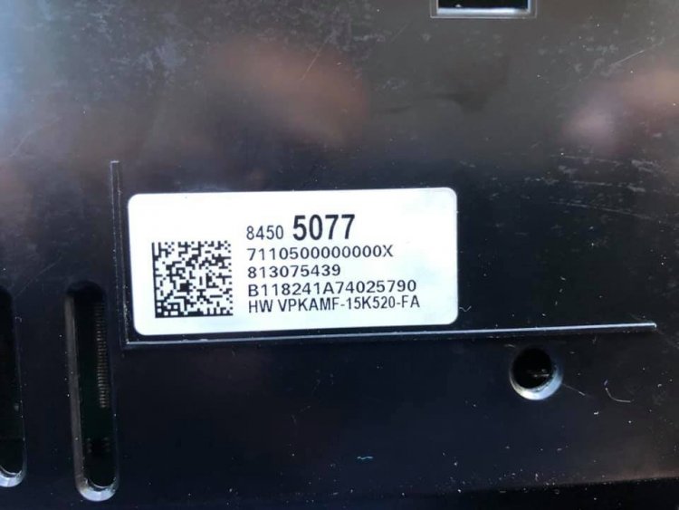

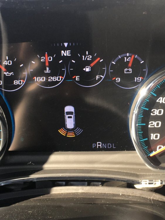

Added my Denali cluster to my 2017 Sierra 1500 SLT

Ebay.  You have to get the exact part number from white auto and media and then ship it to them to get it programmed. Any other part number wont work. GM Parts places on the internet have them as well but are much more expensive. Mine was brand new for 169.  Parts places are around 4-500 and they wont program them so eBay is your best bet. Used ones work as well. Just don't plug them in before they are programmed or it will lock up and be a paperweight  .
Got my cluster today.  Thanks to [mention=130449]GTPprix[/mention] .  Installed this today.  Install took about 10 minutes, but made a "How-To" video anyway.
Enjoy!
