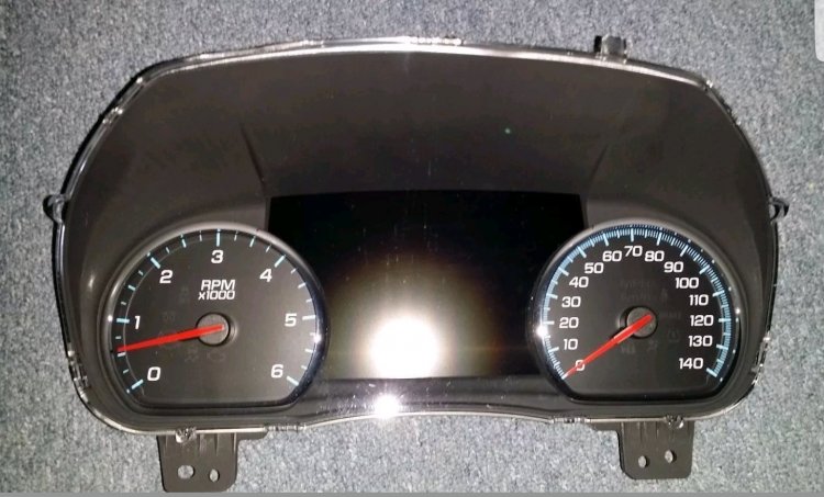

im thinking of getting gtprix denali dash, have a 15 sierra VIN 3GTU2VEC5FG279395 (it wont let me send you a message for some reason.) below is the pic with the dash information.  also how much is it to reprogram it?

Saw this Denali cluster on Ebay.  GM Part #84201626
Best I can tell it is for a 2017, but you will need to research the part number and determine if it is for your year truck.  The auction title IS INCORRECT when it lists it as 2014, 2015, 2016.
They are year specific.
https://www.ebay.com/itm/2014-2015-2016-GMC-Denali-HUD-Speedometer-Instrument-Gauge-Cluster-84201626/173006369610?hash=item2847fbb34a:g:fDEAAOSwySVaHxsp&vxp=mtr
Hope it helps someone,
-S
Edited by SSam
-S
Got excited for a moment when I saw the 842 at the beginning of the part number. Sadly the one I need is 84254166.
The cluster that was compatible with my 2017 Sierra SLT 6.2 Z71 was 84166517.
It was out of a Yukon Denali XL.  The part numbers are crazy on these things...
Here is a pic of the back of the cluster:
Chris was awesome and I am so glad he provides this service!
-S
-S
For sure. He is the one who told me the number to look for also. I need the one from a 2016 LTZ Suburban/Tahoe. Only ones i have found are new. I have a search saved on eBay, hoping one pops up.
