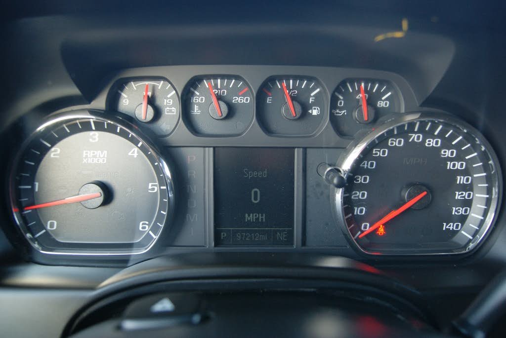

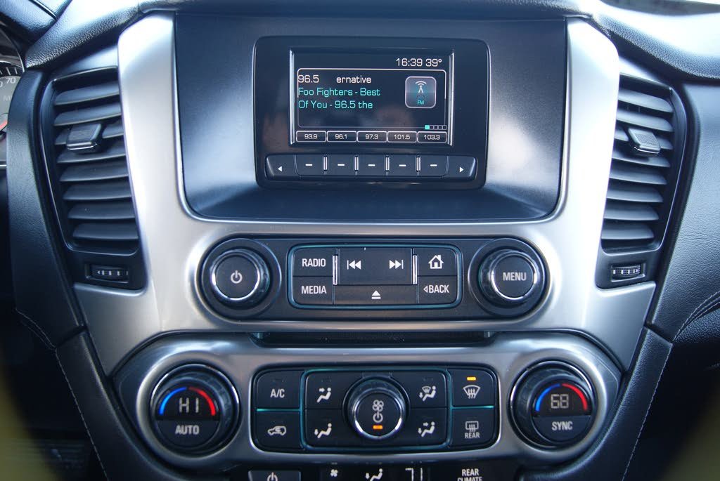

I have replaced IO4, 4” screen, radio module, monochromatic DIC and standard steering wheel w/o audio controls with the following:
- IO5 / 2.5HMI (Programmed by WAMS)
- Radio Module (Programmed by WAMS)
- Color Z71 DIC (Programmed by WAMS)
- Leather wrapped steering wheel w/ full controls. (Non-heated)
The replaced parts mentioned above have already been installed and plugged into the original harnesses.
I am experiencing two bothersome issues currently as the truck sits:
1) Steering wheel illumination isn’t lighting up.
2) Bluetooth will connect, I can hear/receive incoming calls BUT can’t communicate. The other side can’t hear my voice. Also, no voice commands function either. (Steering wheel command and Siri AppleCarplay not receiving input)
Disclaimer: I have NOT started/completed the modified wiring that needs to be done in order for steering wheel controls to properly function. Will doing this resolve the issues I’m experiencing or am I missing something?
I am hiring a mobile electronics technician to do the wiring/splicing needed and want to make sure everything is done in one shot!
Hopefully @Harlech , @pgamboa , @GTPprix , @richamor Or any other pros can give some further insight. ?
To reiterate; I have a 2015 2500HD WT w/ IO4 option code. Huge thanks to WAMS for the programming and getting my project closer to completion.

Do you not have onstar perchance?
Honestly, not sure if the truck came with OnStar. Never subscribed to it. I took some photos of options sticker and interior for further reference.
The Bluetooth input/output on voice worked fine with original IO4 so I’m stumped as to why it’s not functioning now.
*tried uploading photo of mic above driver side visor but wasn’t successful. It’s there though.
I’m not after seeing the label, drop us a line from the site we will get this squared away for you.
Thanks Chris, just sent you an email.
