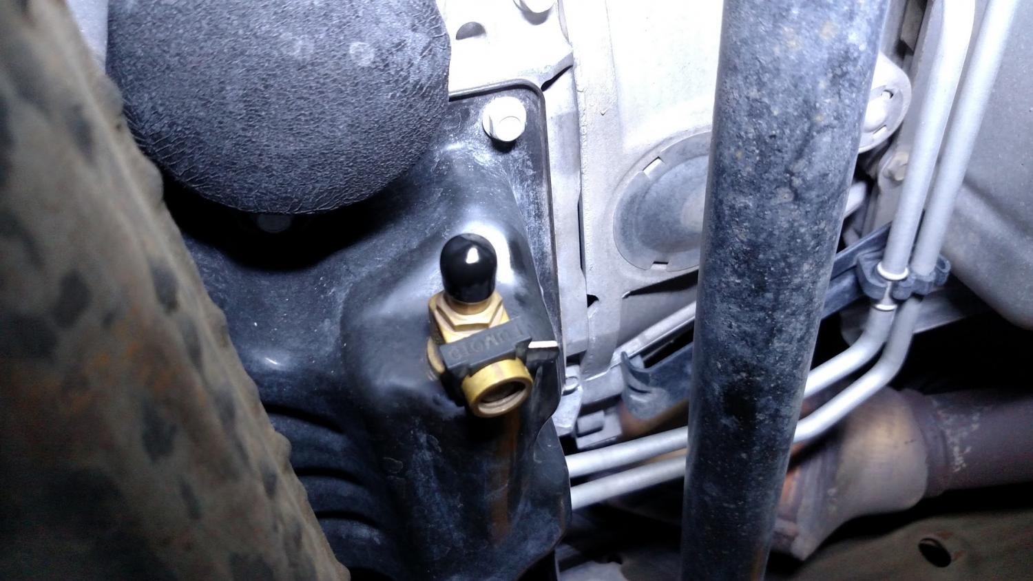

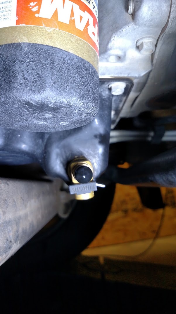

While changing oil the other night I took some pics of my Fumoto F107N. I also have the clip for added safety and a cap that goes over the nipple. I've had it on for a couple years now and it's never shown any signs of leaking. I attach a short piece of hose and drain into a jug. Don't use an oil pan anymore.
The valve is pretty well protected with the engine crossmember just in front of it.

Is there any problem removing the oil filter with the drain stem under it or are you able to cant the filter to the side a little after spinning it off to remove it?

No I haven't had any issues with the valve getting in the way. I just tilt the filter a little (doesn't take much).
Great write up and pictures @gone_fishing. I have wanted to add one of these to my old 08 Silverado and never did. The GMC is definitely getting one.

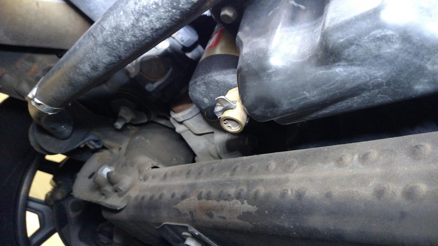

looking at the photos above, i think i'm going to luck out and have the spout on my 107sx point downwards. that will be a nice bonus. can't wait to get mine installed.
