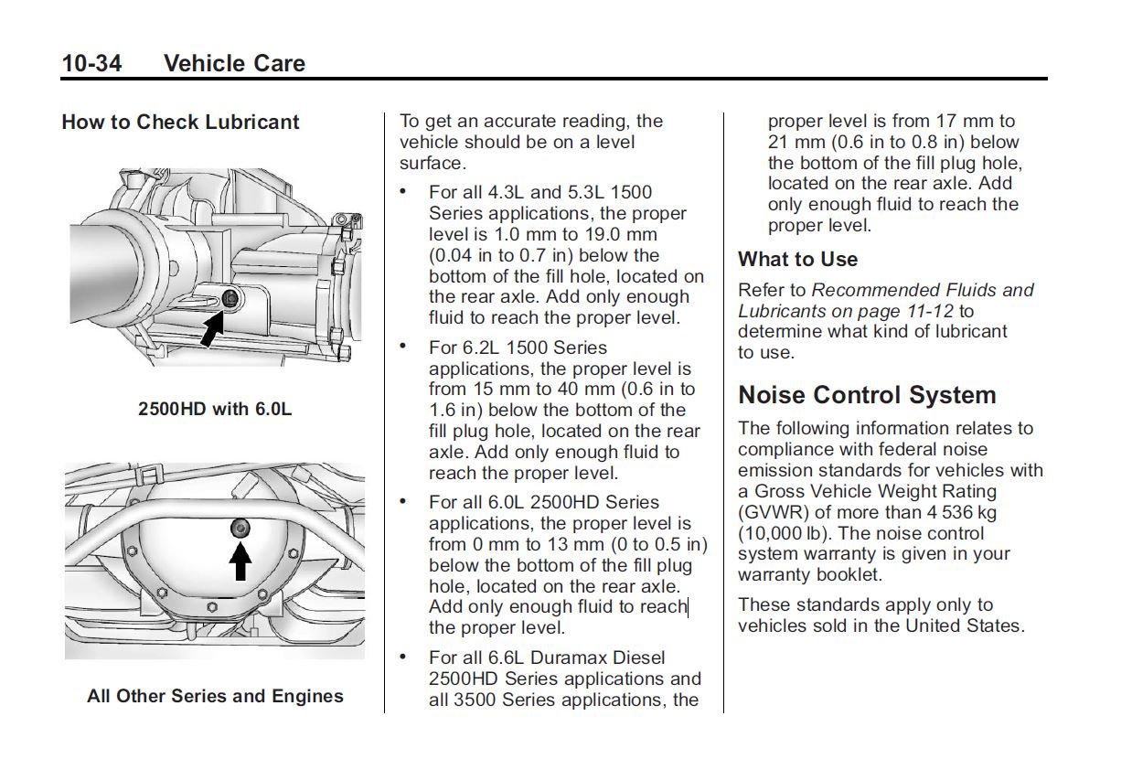

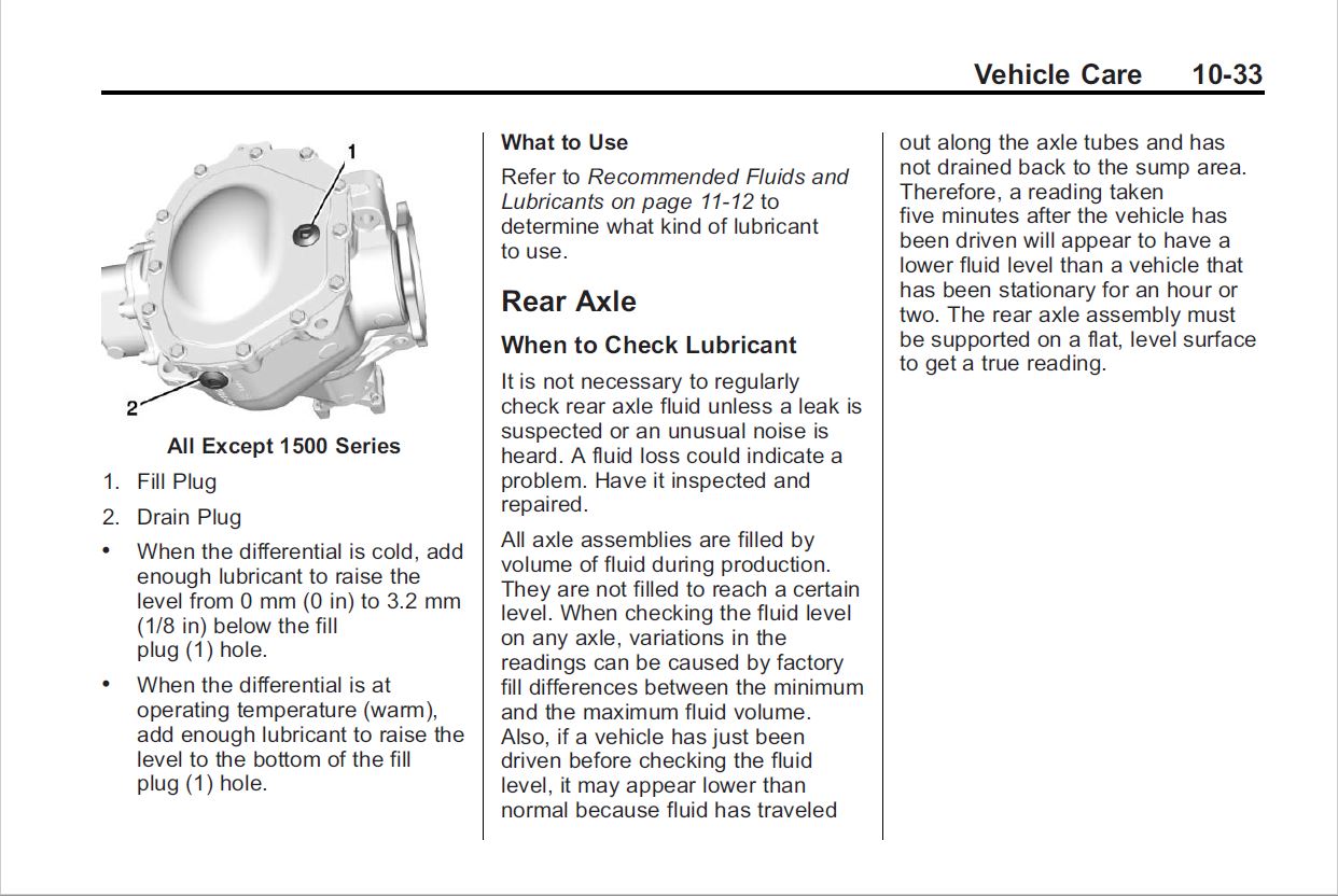

So I am rereading the thread again tonight. I must have misread it yesterday. My picture clearly shows 9.5 and that should be 2.6 quarts. I am over by more than I thought.
I drove the truck to the dump and around town today. It seems to be much smoother and more quiet with the new differential fill. I should have done this earlier. I'll find me a solo cup and pull some of the fluid out tomorrow.
One thing to keep in mind is that the center chunk isn't typically symetrical...if you catch one right, the amount of fluid you can squeeze in will vary. That's why they spec a capacity...but I doubt filling it to the fill hole would cause any grief.
Sent from my SM-T350 using Tapatalk
.04" below the hole is good enough for me. Thanks for posting those pics GoneFishing.
I just ran out and got my owners manual to check. I never saw that when I was thumbing through it.
