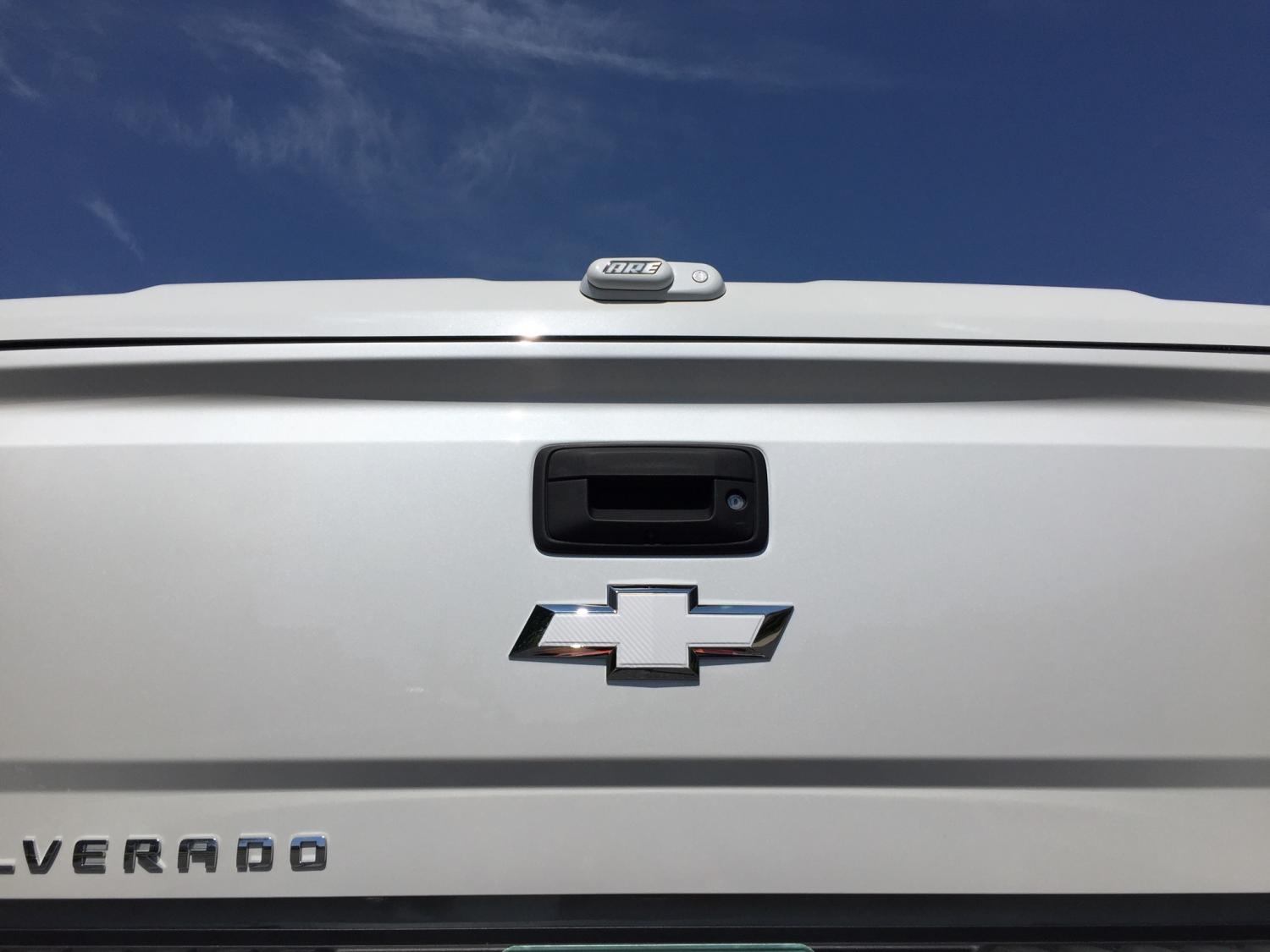

Theres literally a dozed threads on this :) You can either get a vinyl for it online which many have done and I did to begin with, or you can take them off and repaint them. I decided to pull the vinyl off after a couple months and I just painted them. Much happier with the paint and it looks clean.

I Plastidipped mine. Turned out great, stands up to the elements awesome, and if I ever don't like it, I can peel it off.

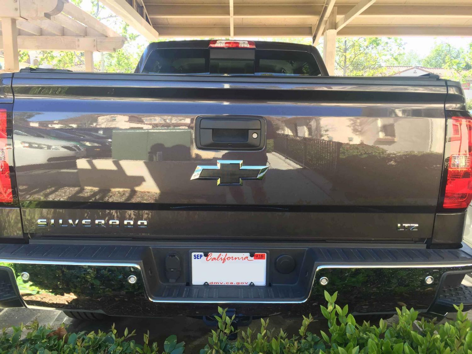

I sprayed mine to match using a kit from eBay and Duplicolor primer/adhesion promoter...
