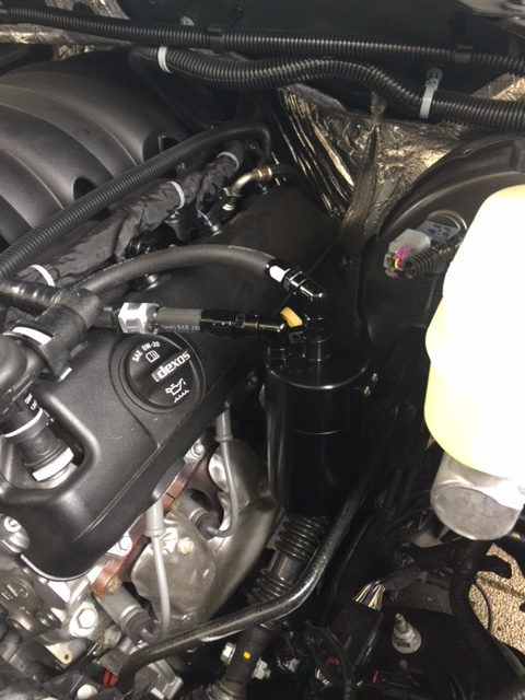

So what's the deal with these? I know zero about catchcans. I've never had one. I've dealt a lot with jet engines and heavy equipment but when it comes to vehicles i've always just stayed on top of the maintenance but never tore one apart or anything. So there's a lot of new things I'm always learning here. I keep hearing people mention catch cans but I don't know if its something I need now or wait to see if I make oil or what. What keeps this pool of fuel or oil from not leaking out everywhere when I hit a bump or rut? How much of a difference do they really make? are they all the same or is it something actual brand name matters?

They're good to have for preventative maintenance for sure. They're placed in-line of the PCV system so that when the gases are pulled from the crankcase, the oil vapor/mist condensates and drops to the bottom of the can then the separated air flows back into the intake manifold. It's more important with a direct injection (GDI) engine like we have now as opposed to a port injection system that has air and fuel going past the intake valves. With a GDI engine, there's no fuel going past the intake valves (only air) to help keep them free of oil from the PCV system. Also, you'll build carbon in the combustion chamber including the top of the piston. I ran one on a C6 Z06 which pulled a good amount of oil mist through because of the high revs. You'll get a fair amount of condensation too but that'll get burned off when the can gets warm enough to assist in evaporation so you'll end up with mostly oil in the can and emptying it at around 5,000 miles is usually good. There's also a "clean side" separator option that runs off the oil fill cap on the valve cover for low vacuum events which I decided against since I really don't hot rod my truck or tow with it. Here's what my E2 can looks like from Elite Engineering.

The intake will only get oil when running it hard and that will come from the hoses leading from the valve covers up to the air box. It only happens with low vacuum situations as the positive pressure from the crankcase will vent through the breathers on each valve cover rather than being sucked through the crankcase vent by the intake manifold inlet. For those events, the clean air separator will help.
