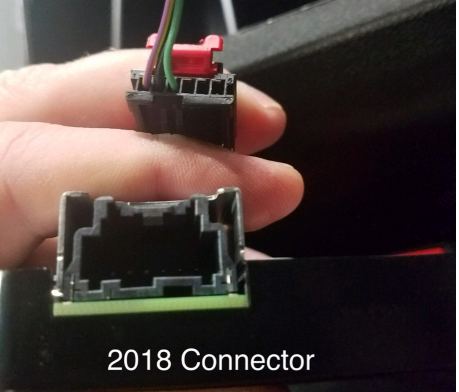

13 minutes ago, scott.moody.9401 said:
Easier than splicing, just trim the tab on the OEM connector. No waiting. 3 minutes and you're done
Sent from my SM-T817V using Tapatalk
Pictures?  Instructions?  Thanks.

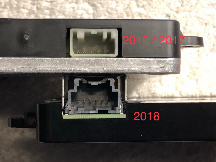

On 2/19/2018 at 4:28 PM, NorCalSLT said:
I called GM Customer Care 1-800-462-8782.
I went to dealer and asked them to assess my wireless charging module as it has never worked for me, regardless of the phones used with or without cases, and both on and off of their approved list that was released January 2018.
(Even though the truck was sold in 2017, so retroactively becoming selective with approved devices? Like lol, what?)
They tested it and used EL-51755 Test Tool, a small tool that to my analysis is designed to sit a wireless receiver in just the right position completely flush with the charging mat in order to get a connection over the single coil, and which indicated the charging module was working properly.
I then asked two of the service men who had approved phones to place their phones in the charging mat. Neither worked, with or without cases.
I also walked them over to a 2018 same exact trim as mine, and had them replicate the process. The phones connected instantly, with or without cases and with plenty of variance in positioning.
While they understood the situation they had to deny replacing the module with a 2018, as per their official testing it was working as intended.

I recontacted my agent at GM CC, updated him on the call with the dealer, and stated clearly that my intent is to have GMC provide for me, under warranty replacement, a 2018 module part # 13521066 and that I will install it myself as I am quite sure the servicemen would gripe about the harness plug being slightly different.

1 hour ago, NorCalSLT said:
Good news, just got a nice call from the dealership that the 2017 module has been revised to address the issue and they will be replacing it for me under warranty this Monday.
Great news - you'll have to report back what they do.  I'm assuming a module revision means they will install the 2018 charging module - don't really see how they could modify the 2017 module.
Yeah, I got a laugh out of it because they're refusing to call it a 2018 module. :lol:
They all specifically say "revised 2017 module", I'm guessing its a 2018 module with a 2017 harness/plug so they servicemen can easily replace.
I will update after my appointment on Monday.
According to pgamboa I thought the 2017 cable would not plug into the 2018 module without some sort of modification which is why he designed the new cable.

Fyi to eberyone needing the plug. Mouser now has 1500 in stock. I just ordered 2.

So i went to the dealership today trying to get some part numbers, since i'm piecing parts individually due to me purchasing a center console lid on eBay that was just the leather wrapped lid. Anyways heres a list of parts that i've ordered so far with the exception of the center console harness.
Center Console Harness P/n:23241964
Wireless Charger Module P/n:13521066
Charging Mat P/n:23264395
Hinge Cover P/n: 23247228
Tray trim P/n:84017364
So far i repined the harness that goes to wireless charger with the new connector, verified that the center console harness P/n:23211330 that comes with the 2014/2015 center consoles did not have the connector provision for the wireless charger. I planned on replacing the center console harness with the harness listed above but found out that its on a national back order with no eta. So once i receive the last piece i ordered, i plan on making a new harness. I'm going to splice into the rear 12v plug and run it to the charger module.
