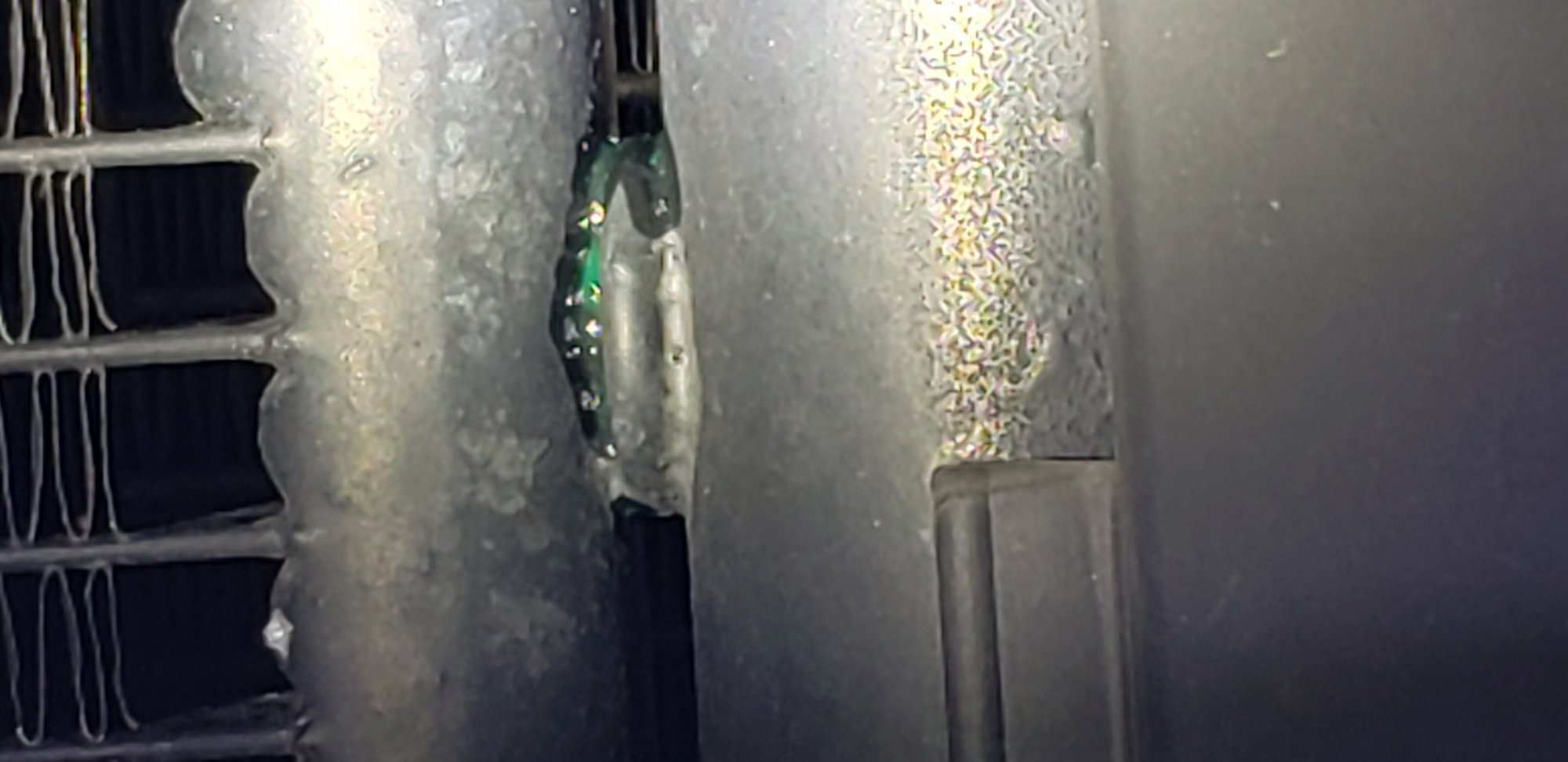

Yup. So is there really an updated part or is it just the same one everywhere.  I just used the A/C in my truck for the first time this season yesterday and BAM, its warm air. I put die in it along with a pound of freon today and i see the condenser is leaking. Its the typical spot on the drivers side towards the top. I took a pic of the green dye.  I also see there is different condensers. Anyone have the correct part number? Its a 14 LTZ Z71 5.3. But NOT the max tow. Thanks all...
This is what I replaced mine with. The OEM one is clearly cheaply made when compared to this one. The weld where mine cracked looked like yours, the new one looked solid and I was very comfortable putting it in and not worrying about it giving out like the factory did.1e60cbffc27af15a75c477b5ab023ba0.jpg

Thanks. Are these better than the factory ones like everyone is saying? I just turned 90k and its the original one i think.
