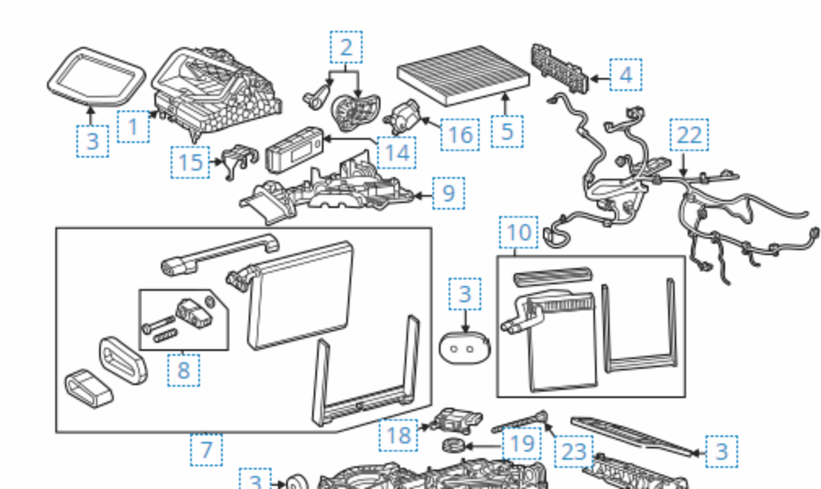

Turns out i have a faulty evap core, service writer said my truck has two of them ?? Claimed the one in the back went bad, thinking he might be mistaken for maybe a suv, do the 14's have 2 evap cores? In any case for those on the fence with a newer or about to get new truck this little problem just made the money i spent on a extended gmpp pay off, one repair, i still have nearly 3 years left on it.
Edited by BIGDOGx
1 Evaporator.....  #7 in diagram below
