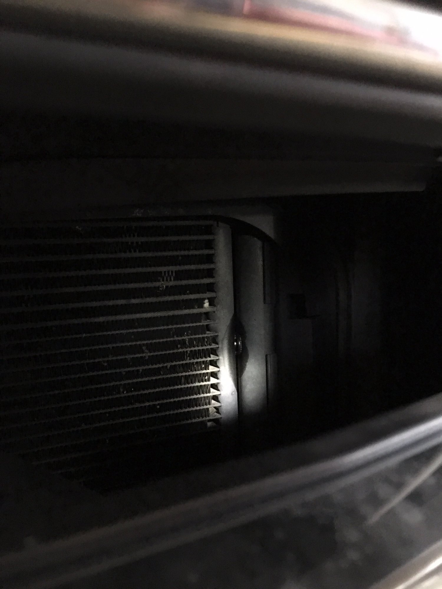

If it makes you feel any better;  it takes a pretty good amount of r-134a freon to refill the truck.  I spent about $75 dollars at O'reilly to buy freon and dye to confirm where my leak was.  The freon then leaked bake out in about 2 weeks.  The two guys I work with, had mom and pop shops replace the condenser.  They paid about $800 or $900 for the job to be completed.  I would get a second opinion if the dealership says a high price.  The job is not very hard to do.  Aftermarket condenser are only around $100 dollars for these trucks.  Three cans of freon off amazon was around $25.  I fixed my truck at 53000 miles and it has been cooling for 4000 miles now.    There isn't a whole lot to remove to fix this.  It is pretty much just the plastic piece and then the core support underneath.  The airbox had to come out.  Radiator then leans back, you pull the condenser out, and take the lines lose.  The condenser is also your transmission cooler.  I had a time getting the cooler lines back on, while the actually a/c condenser lines went on easy.  I think gm buys cheap made condenser and then has the brackets welded on them for the model vehicle they need.  The bracket placement was never intended by the designers.  That is the only way I can figure chevy would let these keep failing.  The condenser is held on the front of the radiator with plastic clips.  Good luck man
