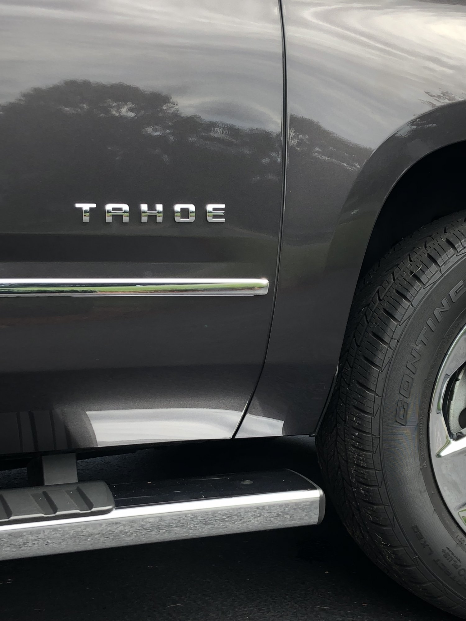

The Silverado on the front driver side of my 2014 was a good 1/8" off level, very noticeable but I never tried to fix it. Glad the truck is gone, never could get used to it being a DC. Love the Crew cab!

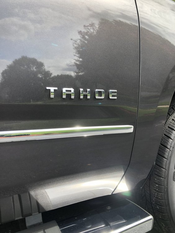

Same thing here. As you can see it’s slightly off. I thought about having them put new ones on but I’m just going to leave it. They will probably screw something up and scratch the paint. My wife thinks I’m crazy but little stuff like this bothers me. At least it’s in the passenger side.
