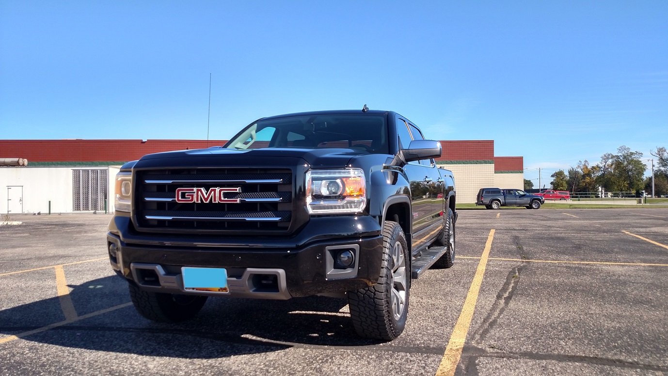

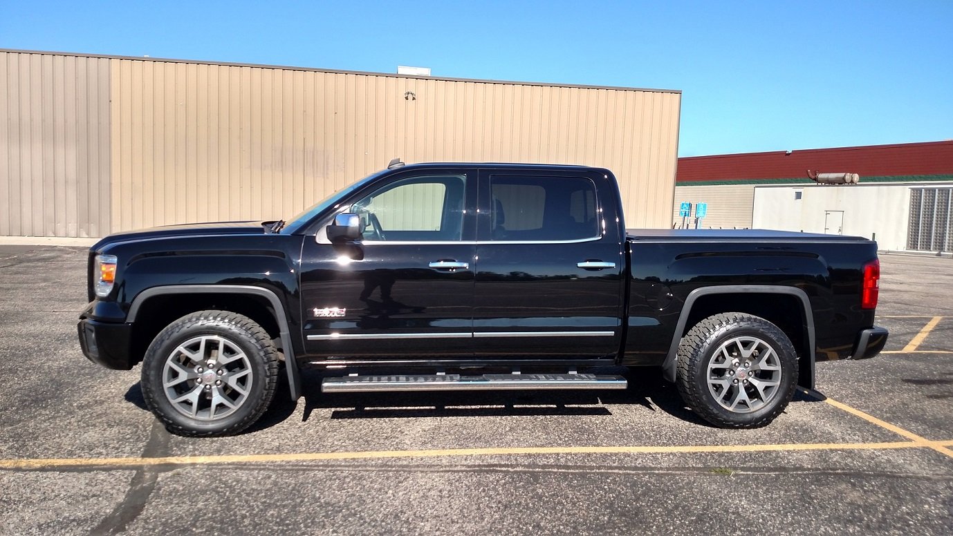

I love my falken wild peaks! A very aggressive tire yet extremely quiet on the road! I’m running 305/55/20fa901a6b194172f093cc3108bb0e8063.jpg12eb2ff2cca0d5bbb243d605d196f1e8.jpg

  2" Level kit?  Any rubbing or spacers required to fit?

2.5 in level, only rub at full lock.  No spacers needed

Nice!  I'm considering a 2.5 in. level kit as well & fitting either 305/55r20 or 276/60r20.  Nearly the same height, but the 305's are 1.5" wider than the 275's.  Don't mind adding spacers if that'll help avoid rubbing.

It probably will fix the rub at full lock but watch it if you add spacers as it will change the steering angles and may rub the bumper then.
