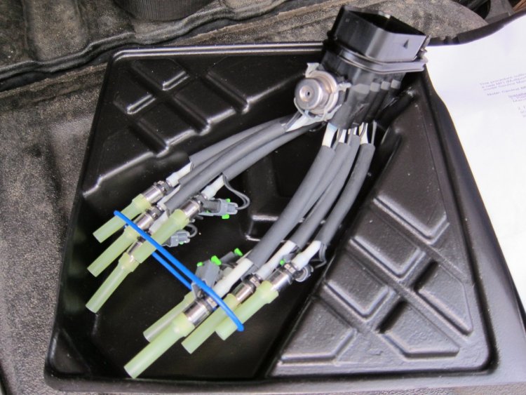

Sounds like you've got a dead miss. I would make sure that spider has all 8 "legs" working - one, or a couple might be dead.

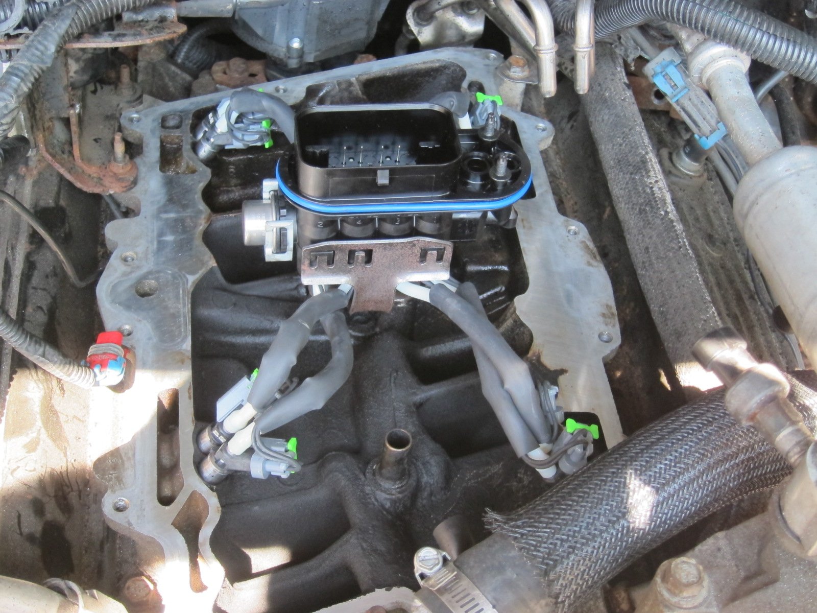

Gordon, here's a couple pics of a new spider assembly, going into a '96 Tahoe, 5.7L - you can see where it gets it's name from, with its 8 "legs" :

Dave, if you're going back in there, press down on each injector electrical connection - one or more may not be fully seated.
