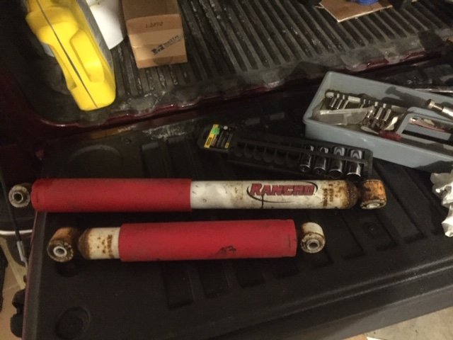

I took off the stock Ranchos and put on their RS9000 adjustable shock, they work great. The adjustments are real and you can feel the difference when playing around with the dial, 2 clicks are defiantly felt. The 5160 Bilsteins where better, but I bought 4 of these Ranchos for the price of 1 and a half 5160's. I turn them up when the 4 wheeler is in the bed, and it dampens the extra weight no problem, no bouncing.

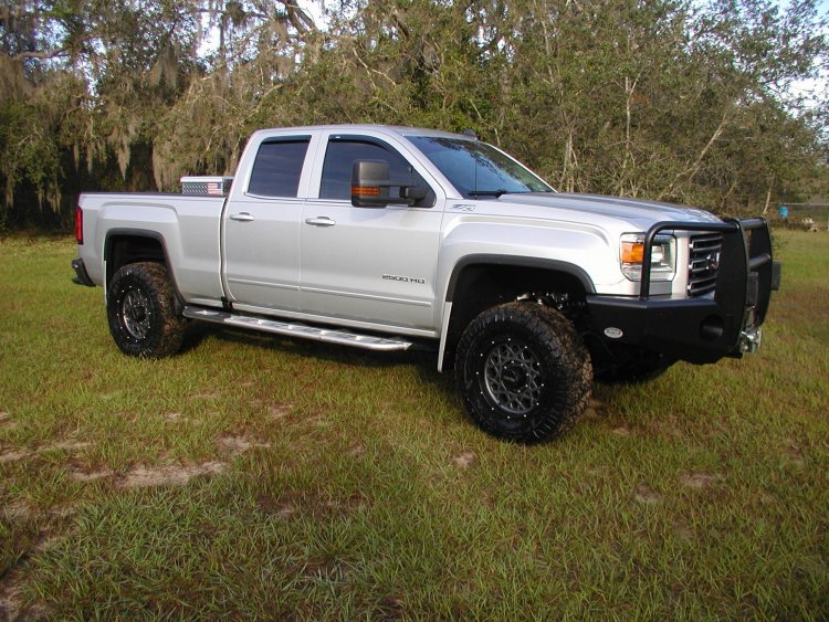

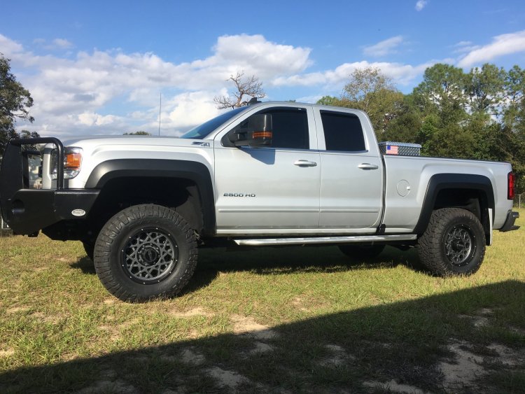

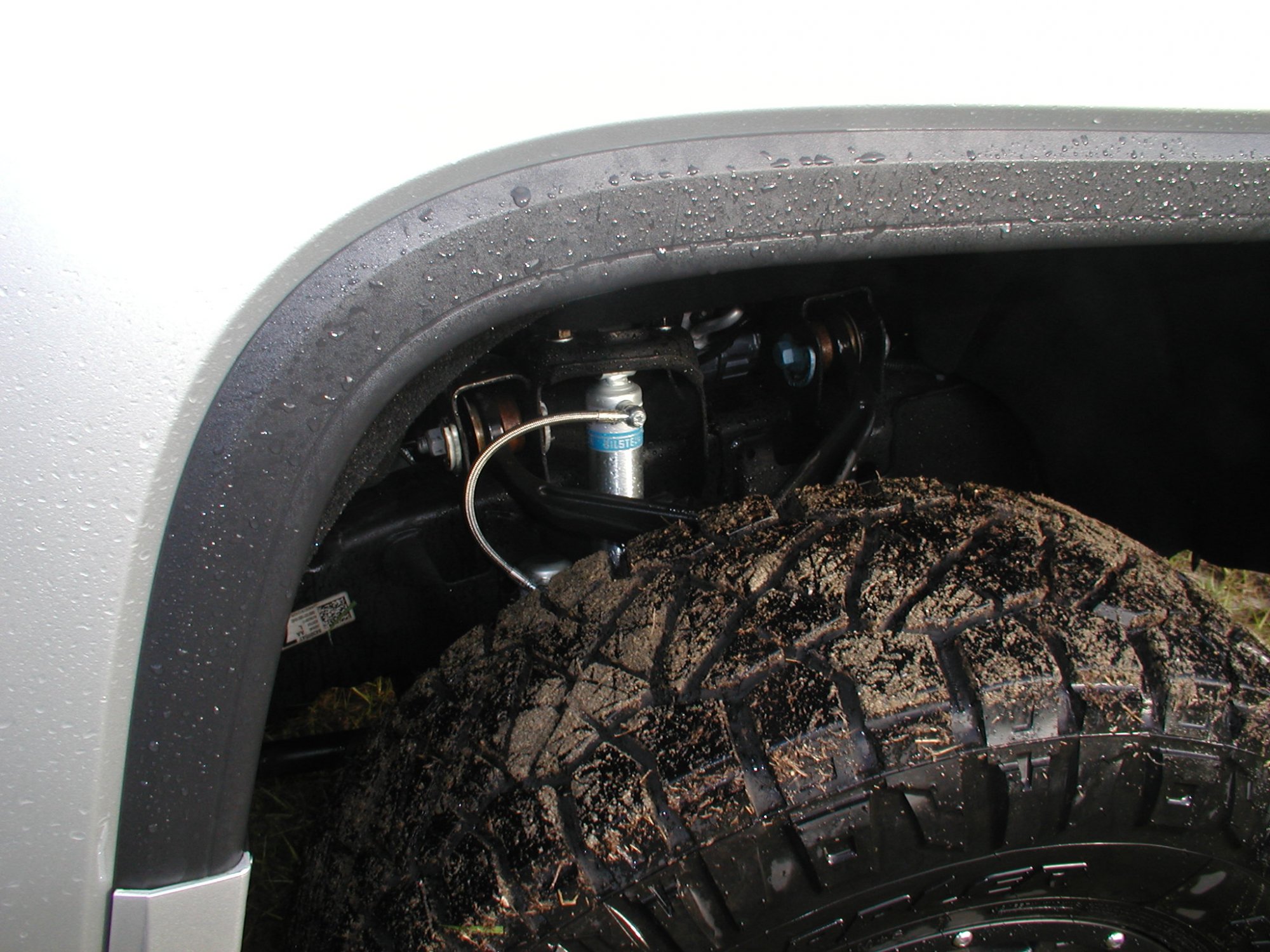

Ditched the RS 9000's for Bilstein 5160's in front with the new wheels and tires. The 5160's handle the 285 75r 18's much better on the hi way bumps and canyons we have here on I-4 right now with all the construction going on.
I've been running the 5100''s for a few months now. So far so good. There is a noticeable difference in ride quality.

Twisting the torsion bar, is twisting the torsion bars, no matter how you do it. Aftermarket keys just let you twist the bar further, making it stiffer. A bracket lift will let you run the torsion bars at the stock adjustment levels. They lower all the suspension components in the front, you have to cut the crossmember to install these lifts, you can go giant high with a bracket lift. Just depends on what kind of tire you want to run, anything above a 35" tire will require either, a true lift, or a lot of cutting....I have aftermarket keys and some shock spacers, my +12 offset wheels and 285 75 18 tires rubbed at full lock, stock wheels may not have rubbed. I have some Cogneto steering braces and Ready Lift upper control arms that I need to put on, any higher, and I would need to cut fenders, or get a real lift.
