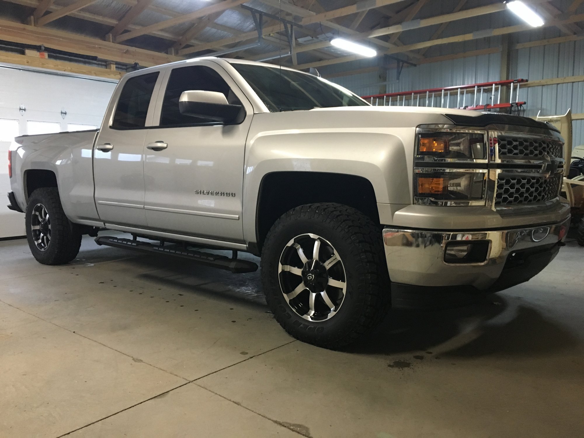

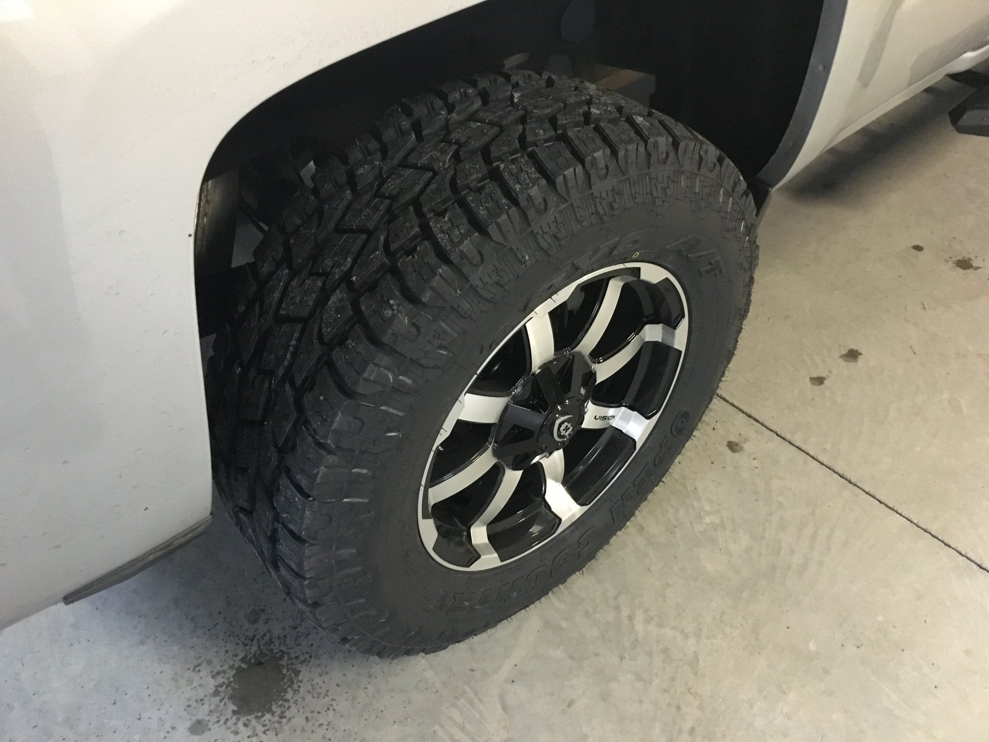

I went up to a 285/65/18 tire. I went with Toyo A/T 2's.
