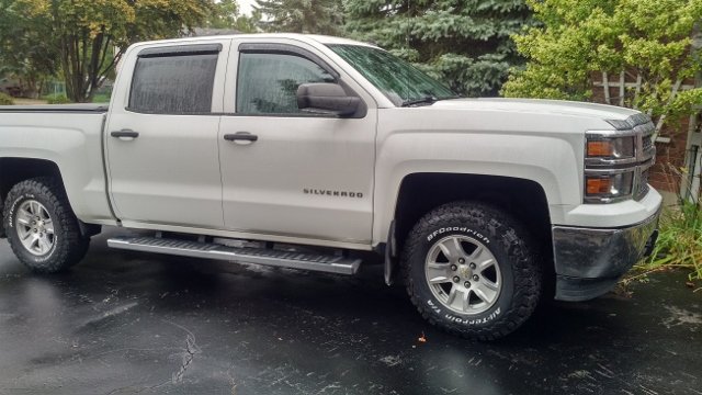

1.5 lift and lower your headlights, i pull a 20 foot lund pro bass boat  just about every weekend in the summer and have no problems
Thanks, What size tires do you have? Any pics by chance?
