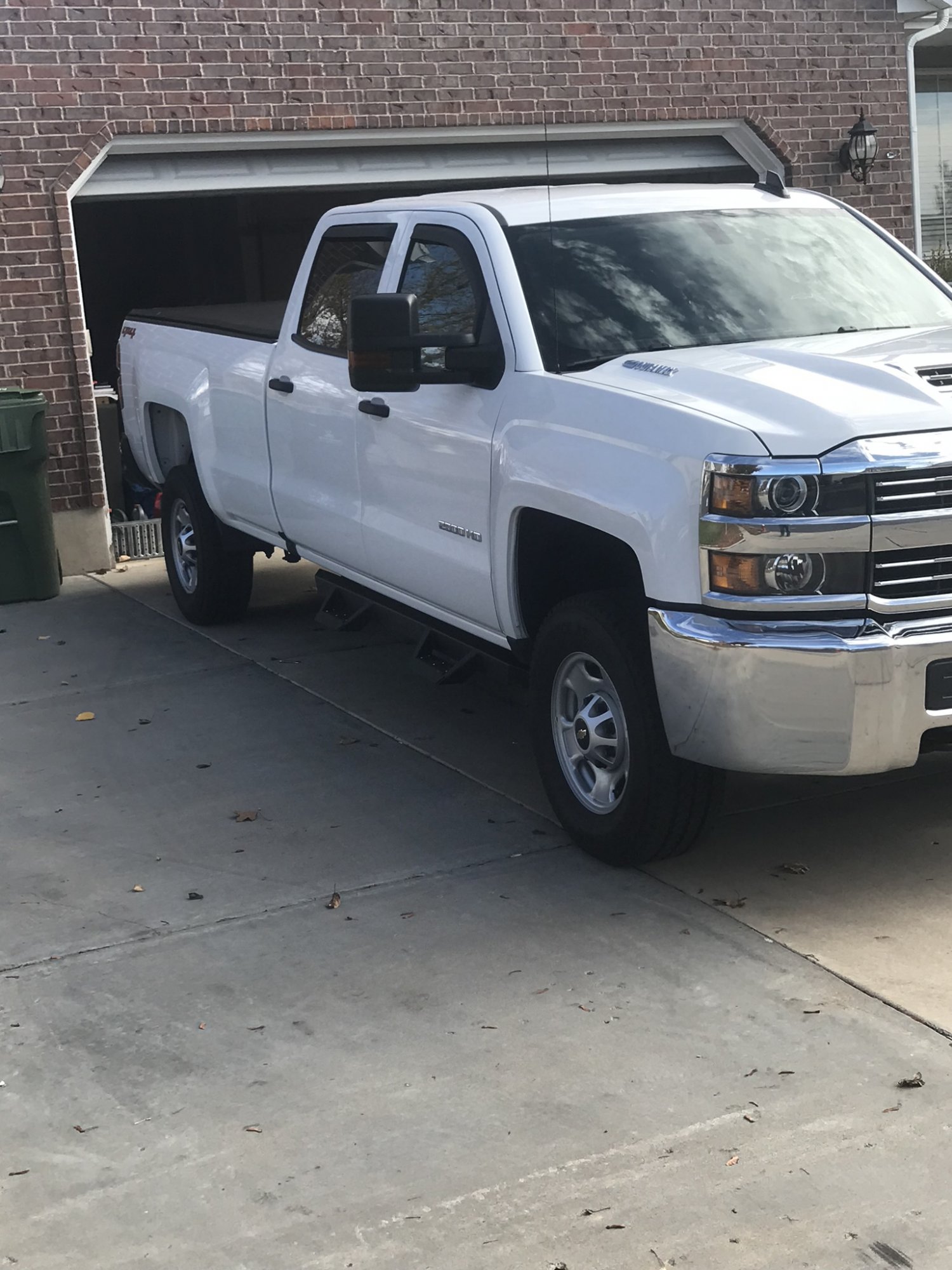

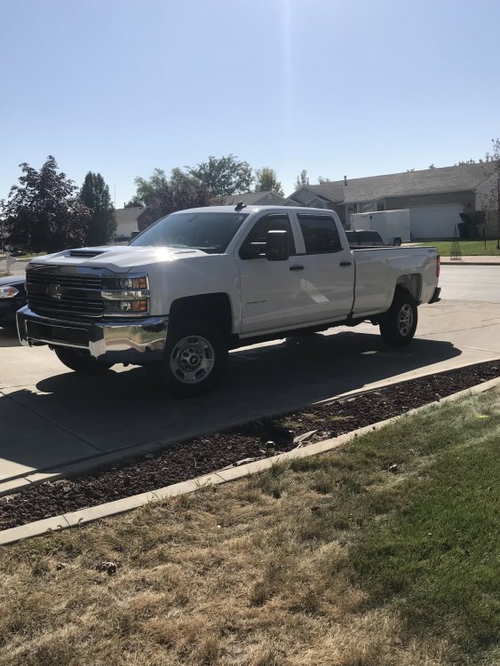

It is doable. But it’s not simple and there are a couple brackets that I left on mine cause they won’t come off without removing the bumper to pull them. And I didn’t want to do that lol.

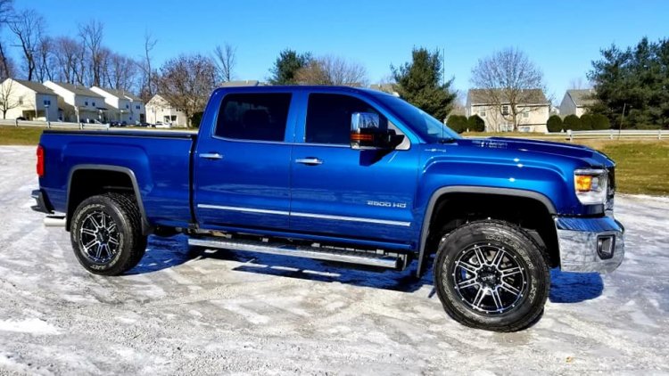

its definitely doable. Our 3500 at work was removed when we installed the plow. It looks great removed!! Not sure how much work involved in it though.
the chevys are not removable, but the GMC still are just have to remove all of the bolts holding it on...
