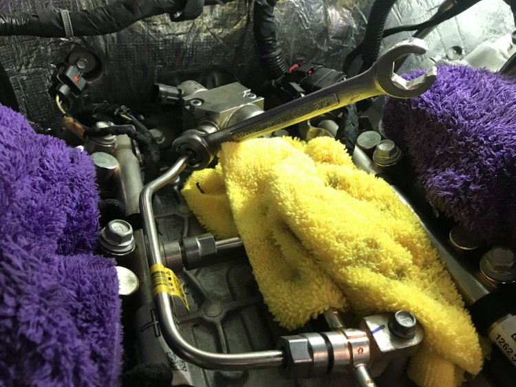

It is coming from the drivers side back of the engine. I am hopeful it is just a high pressure pump that is extra noisy. Won't know until it's replaced. Just received it today. Will replace it this weekend. Will post another video after replacement.

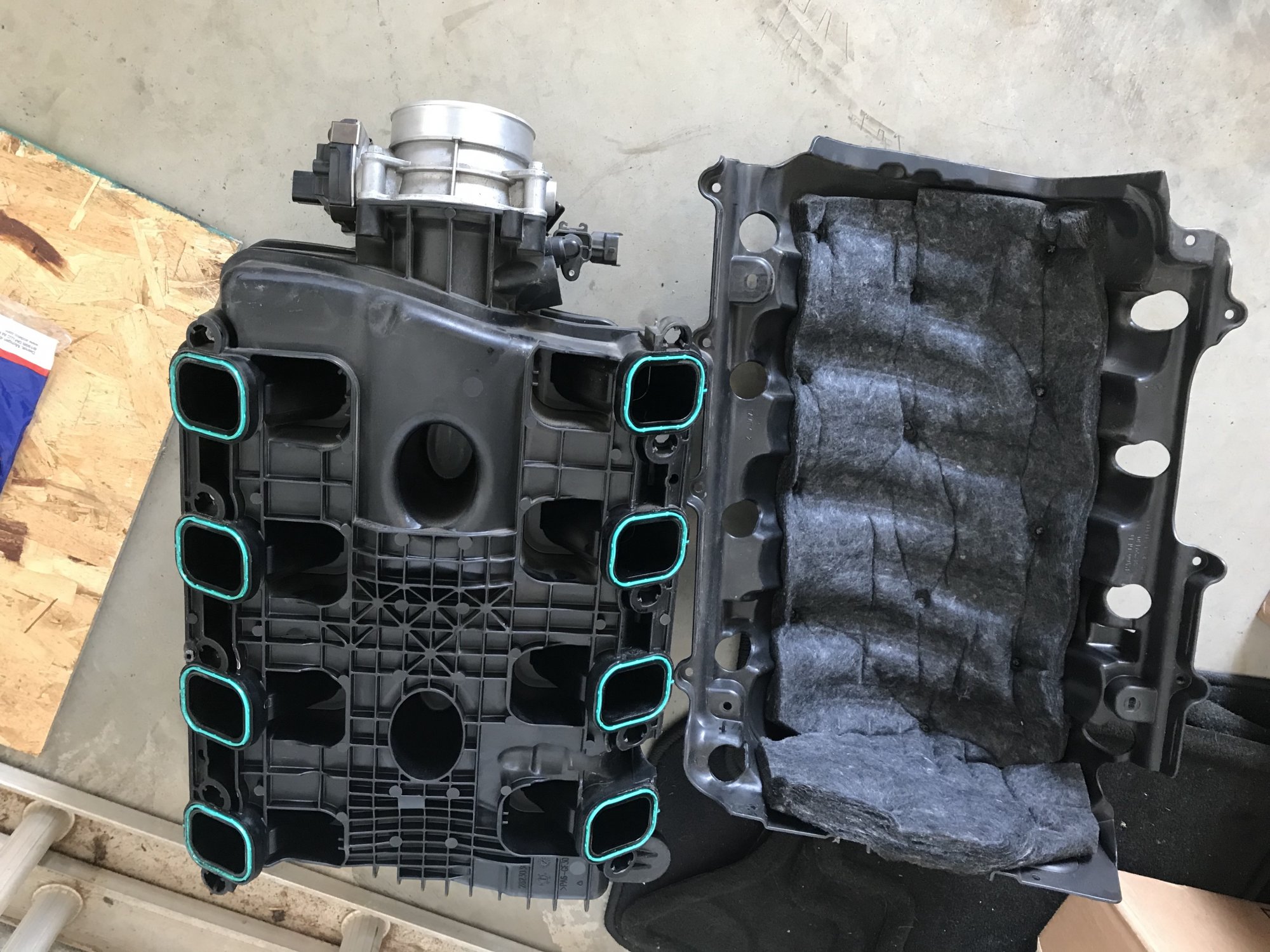

I have a 2015 Denali 6.2 and it has always seemed to have a lifter "tick" and it is noticeable on the DS. But, I also had a 2015 Corvette, with the 6.2 and it always seemed to have a lifter sounding  "tick"  -but I was told that it is the high pressure fuel nozzles and the new style lifters and that even though they have acoustical materials under the plastic plenum, the sound gets through.
I thought that it was maybe BS, but I traded the Corvette in on a Z06, which has the aluminum blower on top and I don't hear the "tick".
Not saying it's right for the regular 6.2, just my personal observation.
