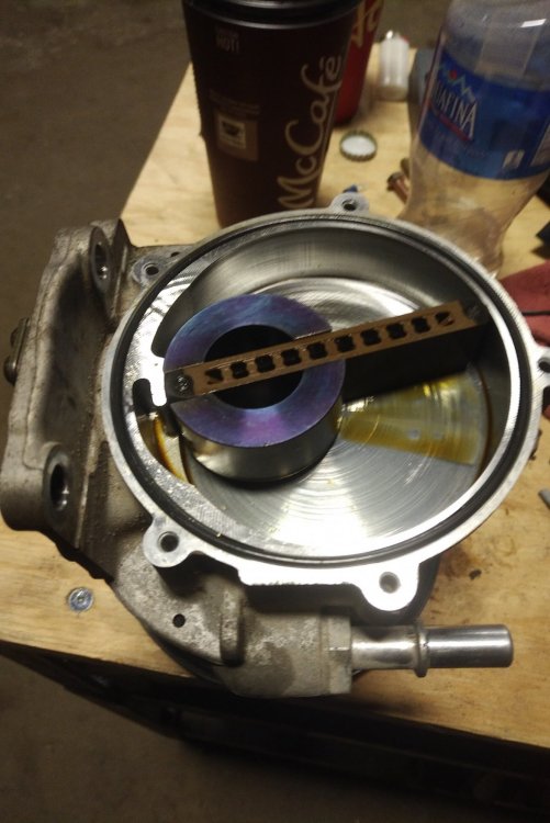

replaced mine yesterday for anyone that wants to do it them selves sambone95 did a good write up in the how to section , i disassembled the old pump and it is easy to see why these things are failing this is the cheapest and worst design of a pump that i have ever seen. i will try and post some pic's later
Did you replace with another GM original or find a better looking aftermarket version? The GM parts sites list a new part number, don't know if this is an improvement over original.
