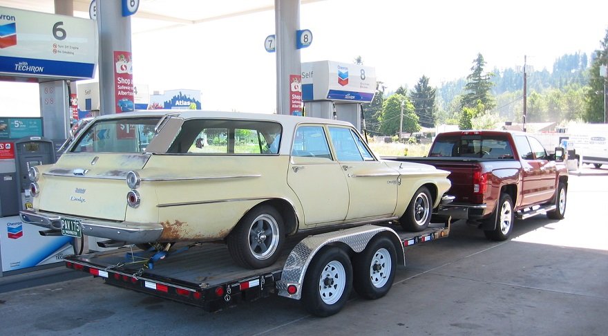

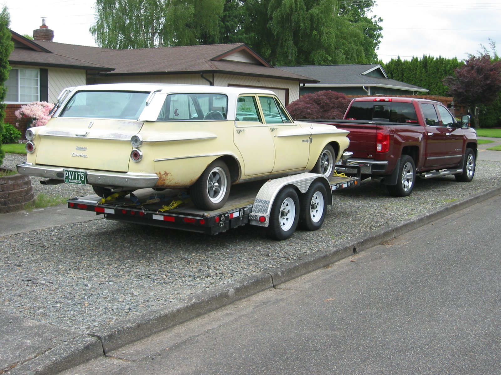

Most def you want the weight distributing hitch when you get a real trailer with tongue weight behind it.  As for the little tongue weight trailer - I towed a car on a trailer loaded with little tongue weight and could not go over 50mph without the trailer swaying - thank goodness for the dash lever to actuate trailer brakes.  Modified the trailer to get the load further forward.  Return trip the sky was the limit - towed great at any speed with more tongue weight.
