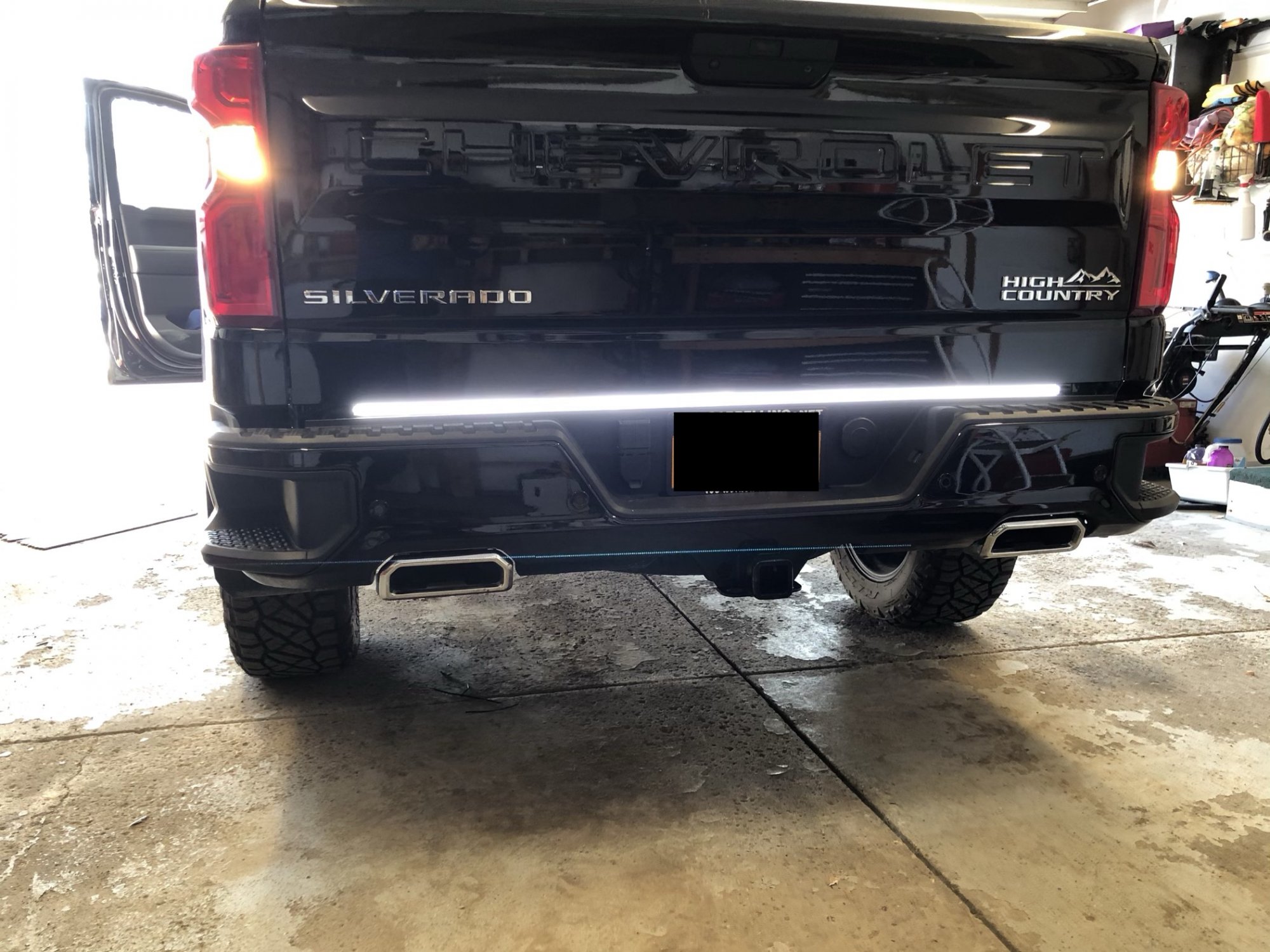

Got sick of not being able to see while backing up at night (blinding screen and tinted windows)
Great idea! Might have to look into this... I’d be interested in a write up too. Also, CT truck here as well...
Not really that flush but the steps are so big it didn’t matter. They’re whelen Pioneer NANO-6’s however any smaller LED would work.
As for wiring, I tapped the reverse wire from the taillight to trip a relay. Power and ground I grabbed from the back side of the trailer plug. I fused it again since it’s better to be redundant, only needed 5 amps.
I’ll look tonight if the screen gets better, I highly doubt it though. However seeing through the tint using the mirrors should be way better.
Installed a 3 inch by 22 inch curved LED light bar. Cut out the plastic under the license plate. Built a frame with aluminum angle brackets. Still need to wires it up. Plan to tie it into the bright lights. acaea4551fb05a204247d91e02bf7f49.jpgab4609835bf859abfd3f5c05eee38741.jpg90cc45ff9ad1df87a4f991310c5d6319.jpg0737e62e0fade1fa11c8fd844ace3830.jpgd58d32eed6712dec58c90e601202c1a6.jpgf48eb5058795e34ff974057c385a51fb.jpg

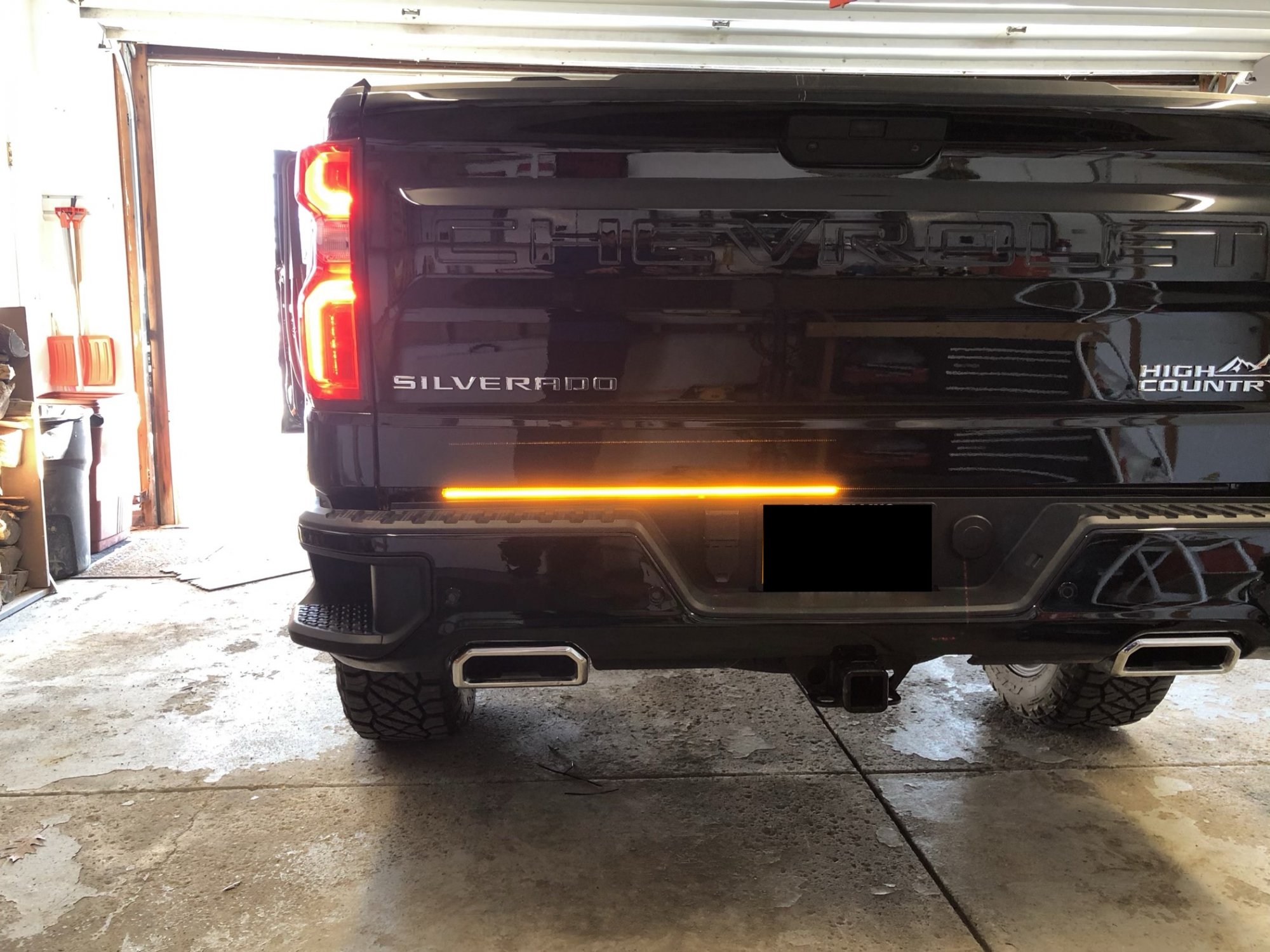

Finally installed a Putco taillight light bar - turns out it's easy with the harness, strongly recommend that for plug n play installation that doesn't soak up a trailer plug (and gives a 4 pin in a pinch).    Also did it without removing the tailgate!   Fully intended to take it off, but then realized it can be done with a helper and some patience.  Thing looks like a light saber under there!
  • Like 3
That looks awesome. I have never really liked those that much but that looks great. Do you have a link to the harness?
I used this one,  as recommended by Putco.
https://www.putco.com/529005
