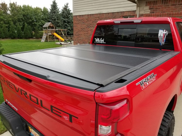

I have the Undercover Ultra Flex cover and it does not block the grab handles.  There is a clamp that mounts inside them but its far down enough where I never notice it when using the handles.20180928_175643.thumb.jpg.4d1ccd0a66070936a534185bbf29dae1.jpg

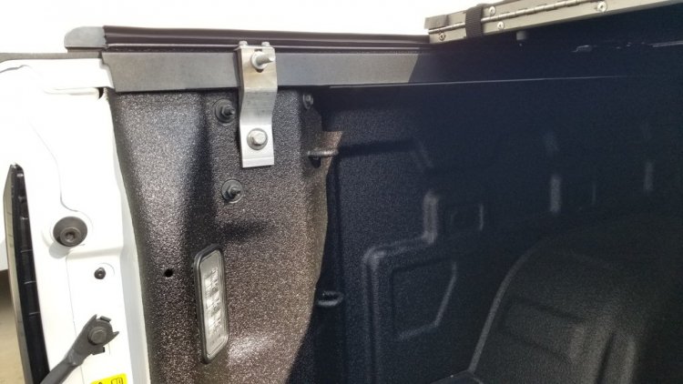

Can the handle be removed to accommodate a tonneau cover? I never use a handle and a good bed cover is important a to me.
I’m expecting delivery of my AT4 next week and Ive yet to find a tonneau cover that works with the Multipro, has the ability to lock and will allow my dirt bikes to fit in the bed. Any help would be much appreciated.

Yes, you can remove the handle to mount the bed cover bracket. attached is a pic of the Fold-A-Cover G4 Elite mount.
Word of caution - You will need to be careful when removing the 2 handle nuts. the bracket that the bolts are attached to, can fall into the cavity behind the bed.

I have the exact cover n   no problem with the grab handle

Grab handles? Does your truck have two grab handles, or are you referring to the stake pockets? If I read the initial question right, the OP wasn't asking about interference with the rear stake pockets, but the folding grab bar/grab handle on the driver's side of the rear of the bed.
