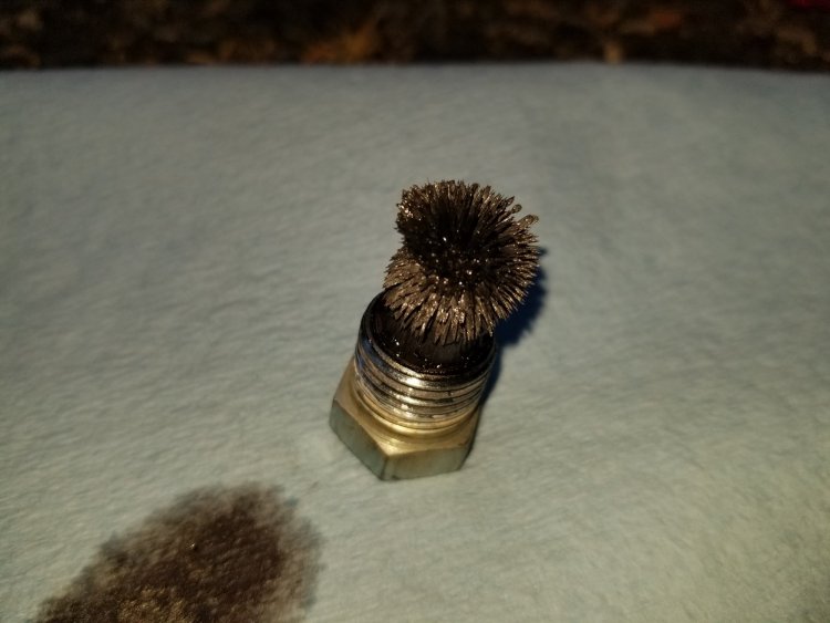

I know it is not the same, but here is the end of my transfer case plug at my 800 mile "flush and fill all the factory fluids".
I sort of wish I had opened the oil filter to see what was in that filter's media too. Sure it got filtered out, but even the best filters are not 100%, so grit is circulating.
I am aware that the transfer case doesn't have a filter, so the magnet is the filter, but when I changed the transfer case again at 15,000 miles, it had no more than 1/10 this kind of "dirtiness".
I am fine with that being proof enough that the first change of lubricating oils and filters, is plenty different from the rest, and not a waste of anything.

Btw - transfer case and differential gears mesh with some significant force... and create bits of metal as they mesh ... the magnet is there for that reason.
The lubricant is different, the temperature regime is different, the metallurgy is different, etc.
