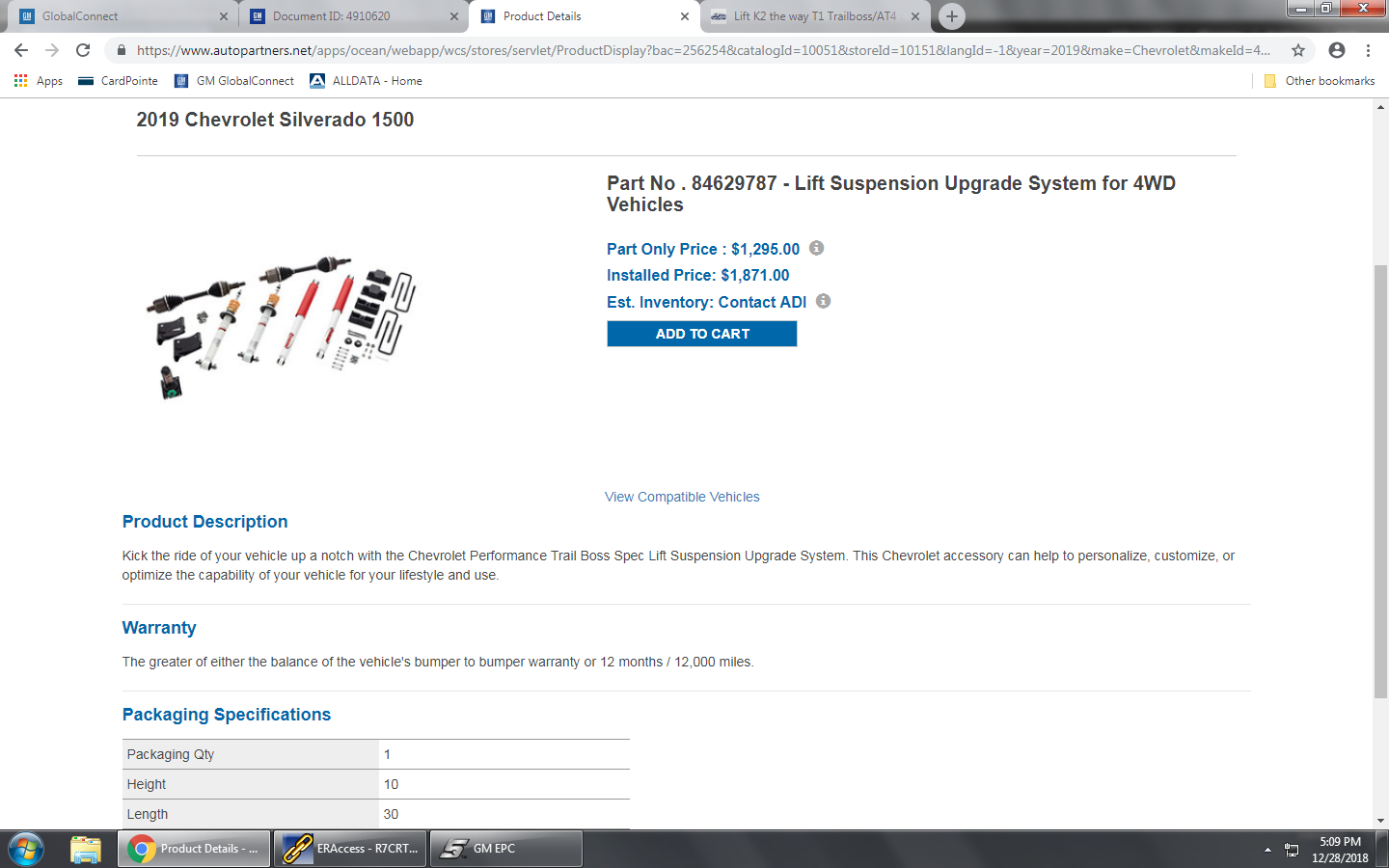

I know I could get a 2” leveling kit or a pair of front 5100s, I guess I should clarify that my question is more if anyone knows exactly what they do to lift the Trailboss and AT4, and then if it would be possible to very closely replicate that set up with my 2017.
Just trying to keep everything as close to OE as possible, and figured following the cues of the T1 would be a good way to do it.
Based on the parts in that picture, I wonder what would make this kit not (at least mostly) fit on a previous gen? It seems like the rear blocks and shocks would fit at least, but I guess parts like the axle shafts might be tough?
