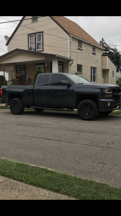

Hello guys. I know this has been asked a million and one times but I seem to be getting no where and the threads seem to turn into more arguing and debating then facts and resolutions. Please be nice as I have knowledge of mechanics but not modifications. I currently have a 2017 Silverado 1500 z71 with a 2.5 rough country lift level kit(RC is garbage I know). I’m looking to lift it 4” this summer. I will be doing it myself with my father in law as he is a master mechanic and I know my way around a truck. I would like to run 33’s with 20 inch rims. In your opinion is a 4” rancho or a 4” BDS the best route to go? I am avoiding RC for the angles and I want quality (you get what you pay for) and I do not want to have issues down the road if I can prevent them now with the extra $ although I am not a millionaire. So my questions are any experience with 4” BDS OR 4” Rancho and which is better and any issues? Any advice on a 4” lift with 33” tires and 20 inch rims?(how will it look?) Thank you all for your help as this is my first truck I am modifying ??
-(silver rims were dealership)
-(black rims are after 2.5 level on it)

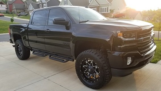

It will look great. Here is my truck with 4" Fabtech and 33x12.50R20 30b7736d74d4af3a3b0f04232ae7826c.jpg16b19c49f5ccd956a0f6c401074b68f2.jpg
