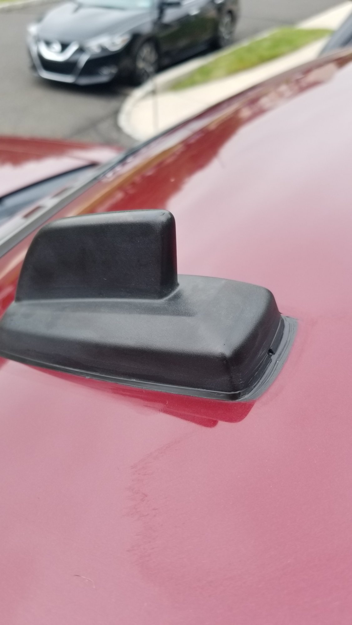

My Silverado truck has about 120k miles and my warranty has already expired. It was raining all day long. The day after, I saw water drips coming out from the roof (see the attached photo).
I went to dealer to find out where does the leak come from. They did water test and told me the leak from the Shark Fin. It costs over $200 to re-seal it.
I asked them what would it cost to replace it, they told me it cost almost the same.
I'm thinking to DYI the sealing, but I couldn't see any topics illustrate that.
I'd appreciate any one can help me with this issue.

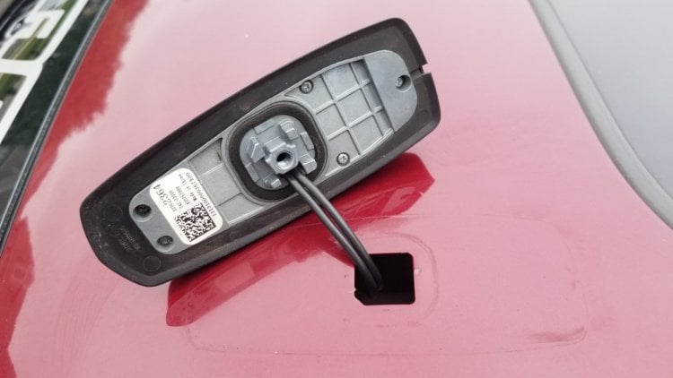

Remove the A pillar trim, grab handle, sun visor, and center upper console. Then you can pull the headliner down enough to get your hands above it. Unplug the 2 plugs, and remove the bolt that holds the ant bracket. I think its 10mm, but it might be 8mm, I don't remember. The bracket only goes on one way, so pay attention. Pull the ant out, clean the sheet metal. I took my ant apart and cleaned and dried it. I silicone the crap out of it, then reinstalled. Hasn't leaked since. I did the 3rd brake light as well, because it'll leak too. The "gasket" on both is foam. Foam gaskets WILL eventually leak. Good luck...

See pic above.  Its because that little gap in the gasket/seal.  Not sure why its not a solid piece all the way around.  I filled that gap with clear silicone and mine has been good since

The bigger antenna incorporates the WiFi wiring, so the newer ones are larger. They all have the same water intrusion seal. They also have a barrier seal (not water proof) that the antenna sits on so it doesn’t just sit on painted metal. Those all have a little gap. The older trucks had that gap in the back, the newer ones have the gap in the front.
I think the gap is there so IF water gets in, it can get out. I sealed mine completely. So no water in AT ALL... I sealed both the inside and the back open end of the seal.
