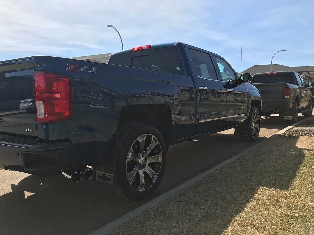

Ive had a Borla type S cat back on my truck for a year so far and still really love the sound, its not overly obnoxious like the atak which I initially wanted but living in a very cold region I didn't want my neighbours to hate me on a cold start up. borla has really good sounds clips of all levels of the exhaust for the Silverado/Sierra on their youtube channel. IMG_6815.thumb.JPG.de43ea6d9314b0bb4ad8c903d79ed006.JPG
