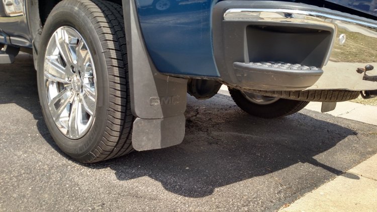

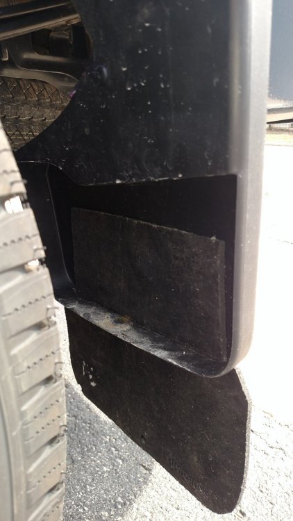

Here is my mod to my OEM mudflaps.
1. I bought a couple of large, plain rubber trailer type mudflaps from my local Farm and Barn
2. I then cut out a cardboard template adding 4" of length that matched the bottom edge of the stock ones.
3. I then cut a 1/4" slot in the bottom of the flaps with a jig saw.
4. I used a band saw to cut the flaps to match the template. (A pair of strong scissors with work too.)
5. Finally I glued them in place (after washing mating surfaces with alcohol) with some Goop marine contact adhesive that works with rubber and vinyl.
This should better protect the bottom of my truck and running boards!
