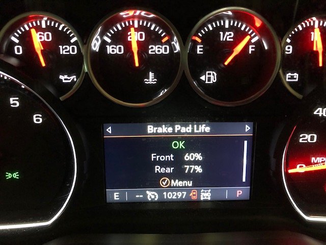

Here’s mine. 70% highway driving. At dealership now for oil change, etc. will update when finished.
Any update?
23 minutes ago, ddevos said:
Any update?
“Brake pad life shows minimal wear. But I’ll contact you in a week and a half so that we can try to give you a loaner to investigate the problem. We will need your truck for a few days”. ?
Go figure.
Mines also showing lower than would be expected. I did have pads changed on left rear for another warranty related issue 4-5 K ago.
i believe he said hes gone thru 20%....which seems reasonable for 13000 miles. im in the same ballpark with 10000 miles. without factoring in driving habits and paths traveled it seems normal. I have larger wheels, heavier tires, i tow occasionally. I look at the information as a helpful guideline rather than something i worry about. brake pads like tires are going to need to be changed eventually. beats the old days with my nissan armada when i was having pads and rotors changed every 15,000 miles cause nissan didnt put adequate size brakes for the size of the truck.
