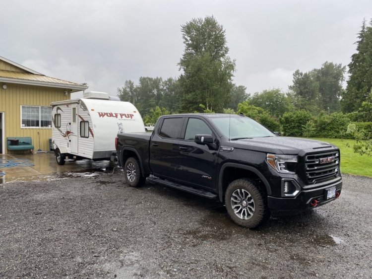

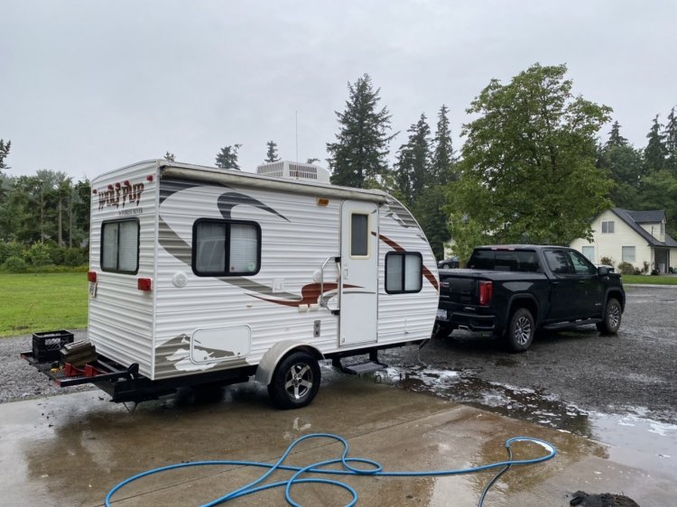

Love how this truck pulls my little trailer. Much better than my 08 Dakota. No problems up those steep canyon roads.

Very nice set up, my neighbor to the north.
Gray clouds look very familiar?

Thanks. It was raining so hard that day. Helped in washing the winter grime off the trailer though.

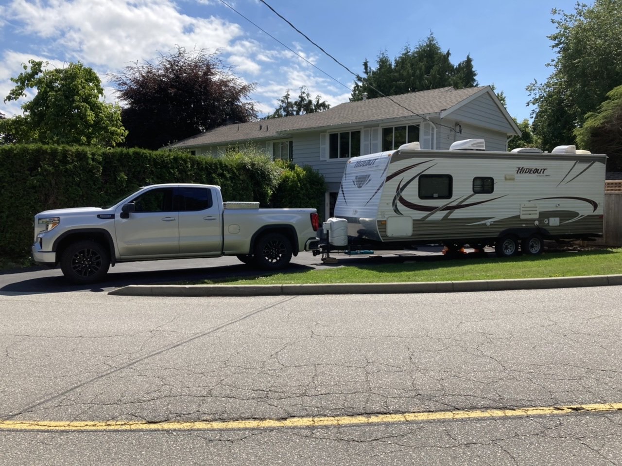

Brought our 24’ Travel Trailer home from my dad’s farm.  New truck tows like a champ.  Has the max trailering option.
Levelling kit on truck causes a bit of squat though even with a WD hitch.
May need air bags to compensate for level kit.

Do you have any adjustment left in your WDH? Maybe one less chain link on your bars would get you level?

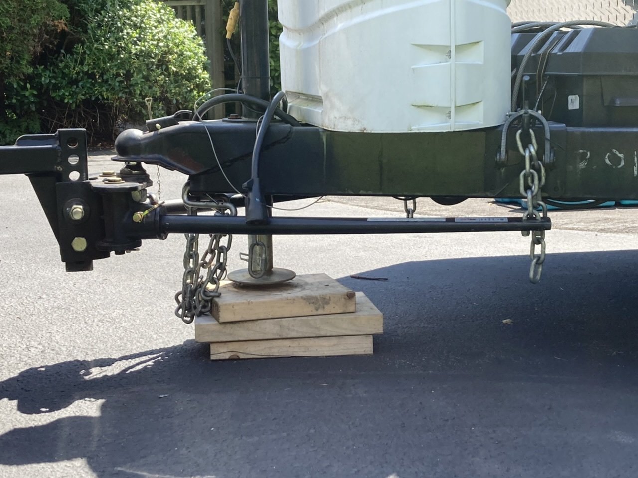

No my torsion bar height seems maxed out.  Tried going up another chain link but it’s too tight to lift it into place.
And yes the jack is up a couple inches above the wood blocks in the pic, looks like it may be touching lol!
The rear sag isn’t too bad.  From fender to tire is 5 1/2” up front and 4” at the back.  Unloaded I’m about 6” front and back, with levelling kit.
At the end of the day if you want to tow with a levelling kit, plan to install air bags I suppose.
Trucks come out of the factory with a natural rake to compensate for loading.

Right on. I’ve had a few friends who were “told” how to setup their WDH but didn’t know there was some adjustment to dial it in perfect.

Yea, know what you mean on both, it had rained the last 6 weekends in the Seattle area before this one.

Try to tilt the WDH head down you should be able to loosen the bolts, add a shim or washer between the head and shank to gain some additional leverage on the WDH spring bars you should be able to get more weight transfer to the front wheels.

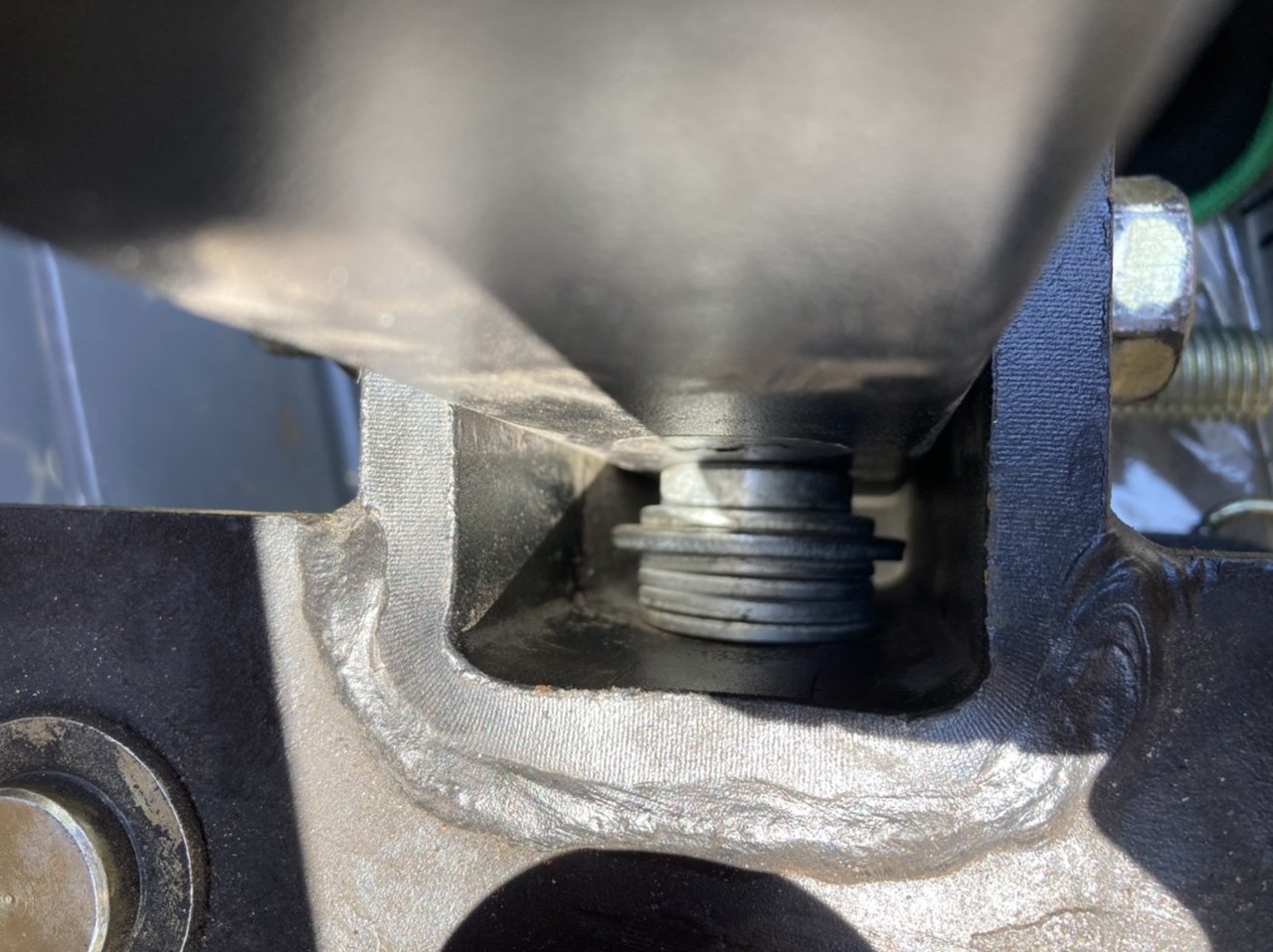

Thanks.  I just adjusted the tilt by adding another washer.  Don’t think there’s enough room left on the shank to add anymore so I think that’s all I can do.
Hopefully my truck doesn’t drive all squirrelly!
Big/only reason I was able to get this truck because I promised my wife it would handle our TT better than my old truck lol!
I’m hoping I don’t have to go out and get airbags now!

What's interesting about your picture is that your shank seems to be angled up.  Is there a lot of play in your shank when in the receiver?  I had that problem on my 2008 Tundra.  The whole WDH would tilt up because of the loose fit in the receiver.  Then I had to add a lot of washers (head angle) to get the WDH set up properly.  I added a thin shim to the shank to make it tighter in the receiver.  Then I honked down so hard on the WD bars that I bent the receiver on the Tundra.  Oops.

Mine does that what kind of shim did you use?
