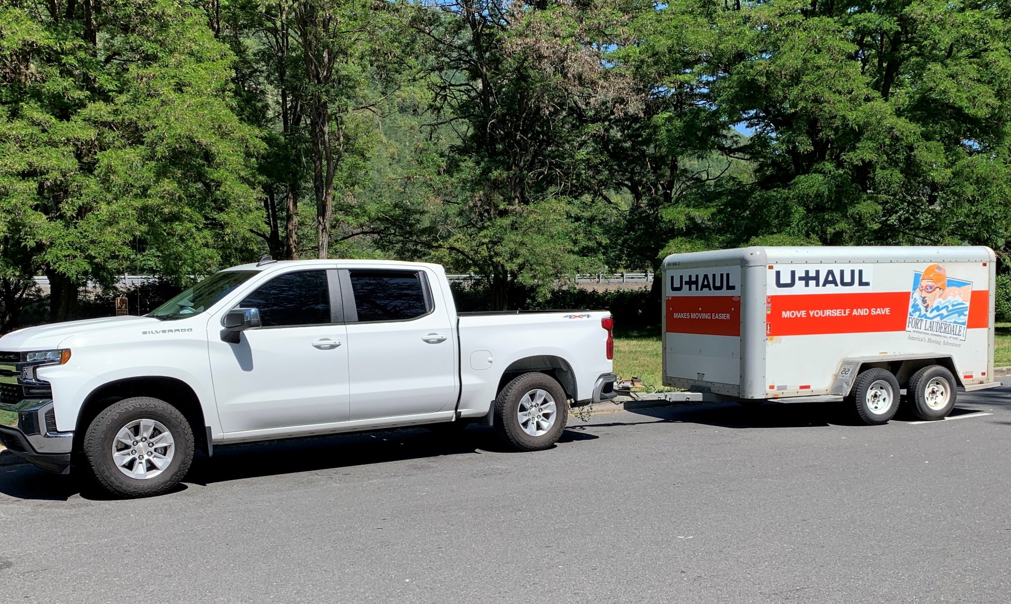

On 6/3/2019 at 12:29 PM, BlancoSilverado said:
The Bay Area, CA to Seattle, WA.
830 miles one way. Came back, Blanco has 5500 miles now.
Was getting anywhere from 11-15 mpg on average doing 65-72 mph on a "closed course" empty or full. The trailer is a brick.
I believe you're not supposed to go over 55 mph in California while towing (more than 2 axel total). ?
