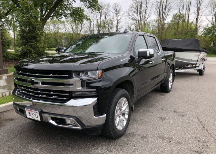

aside from my boat i also tow a 6x12 v nose enclosed trailer, with the extra head room as well. my truck is 5.3. Felt fine and one trip i went on a winding steep hill with no issue at all. back when i has my 2015 i towed a tracked skid steer and trailer just fine. in some conversations i had with some dealers over the years they told me they have seen a lot of notorious 2500 customers stepping down to a 1500 cause the increase towing abilities and the better day to day driving.
