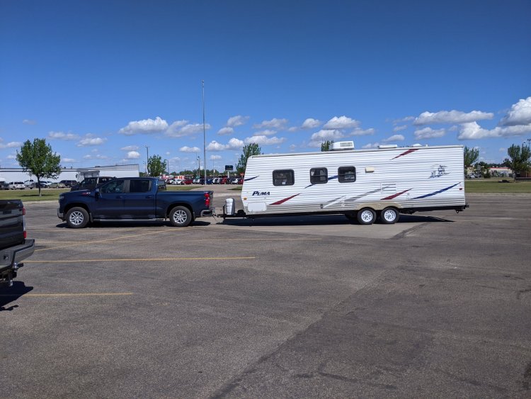

16 hours ago, Moend said:
What are the specs of your travel trailer, how does it handle, do you use weight distribution hitch.
I just bought my first camper and lets say towing it is not fun. Especially without the WDH. i also feel that the airstream are much better travel trailer for towing.
Trailer is 27’ and model year 2018. Dry weight 6,396,  Payload cap 1,204, GVWR 7,600, Hitch Weight 929. Using a Equalizer 90-00-1200 hitch system and tows like the breeze.  Airstreams are quite aerodynamic for towing. Wouldn’t recommend them for family camping due to the size. My wife and I plus a 70# dog are comfortable but adding numbers for any extended length of time would be cramped to say the least. Current trip 606 miles, average mpg is 11.5 and I have the 6.2 V8. Pretty flat terrain and 64–68 mph on the highway with minimal wind. My only complaint is the combo of mpg plus one size fits all fuel tank equals frequent stops to refuel.
Finally, a WDH will make a big diff for any travel trailer. Wouldn’t tow without one. Happy camping!
Edited by LowCountryDenali
I towed a travel trailer with a 5.3 double cab with no issues what so ever, I recently bought a new crew cab which squats way lower than the double due to more weight being towards the rear. Bought the Andersen WDH and it solved all my problems definitely worth it, much better than than traditional wdh bar set ups no binding when backing up and zero noise. I would suggest some type of WDH, your front end is way too high based on your pictures.
I installed a WDH, and it made it a lot better but still a bit squirmy when car passes (over take). For some reason passing traffic from the opposite direction had no effect (2lane back road) going 65mph

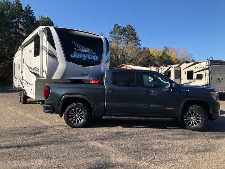

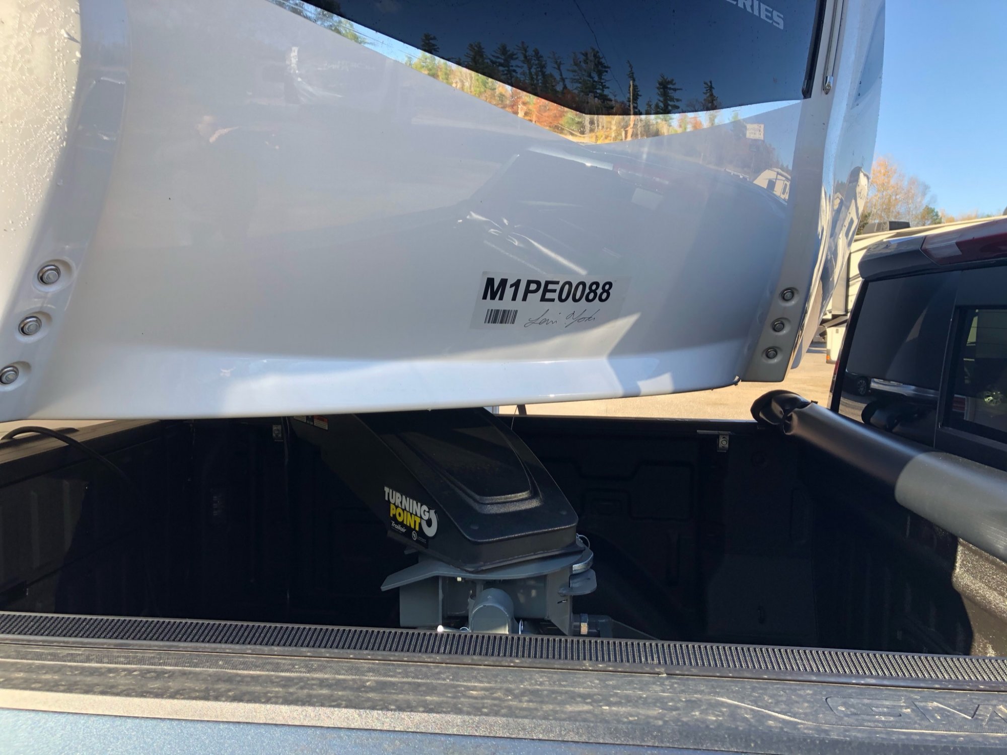

Towed this for about 20 miles yesterday just to check out turning clearance on the new short beds with a different trailer and also to see how my Timbren SES load levelers worked.
Cool setup. How did it handle?
Surprised you have the payload capacity for a 5th wheel.
