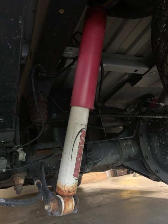

The Culprit is your Failing factory Rancho shocks that come on Z71 package trucks.
They become Pogo Sticks after a certain period of time or mileage.
Replace with a good aftermarket brand, ie Bilstein, Eibach, Pro Comp SS etc and enjoy the ride! :thumbs:

Here is a picture of the Rancho shock at only 5300 miles.
If it looks like this on the outside what is happening on the inside?
And a short video of what happens to them when they fail.
Nothing more than a pogo stick which is exactly what mine turned into.
