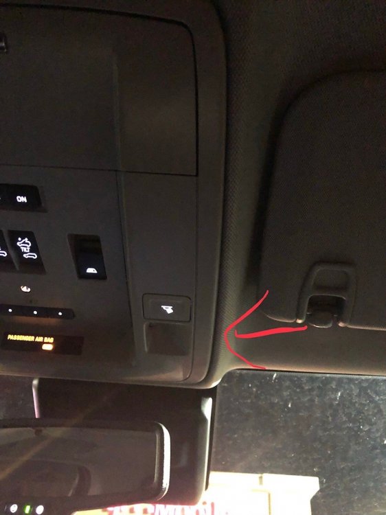

I have a 2015 Silverado Crew Cab LTZ and I keep finding the passenger front seat belt being wet after it rains. I've also seen water dripping from the passenger side of the upper center console (pic attached).

I'd think you have a leaky antenna on the top of the truck. Sometimes it's not sealed in, take it back.

If it is not a faulty Sharkfin, common areas to check would be drain tubes for sun roof, seal on glass of sun roof,
more extreme places would be a leaking windshield, and most extreme because of location would be third brake light housing, which it could be with a wet seat belt, water will travel forward.
I ran a thin bead of clear silicone around my 3rd brake light and it stopped my leak permanently.
