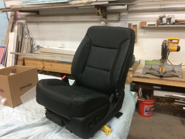

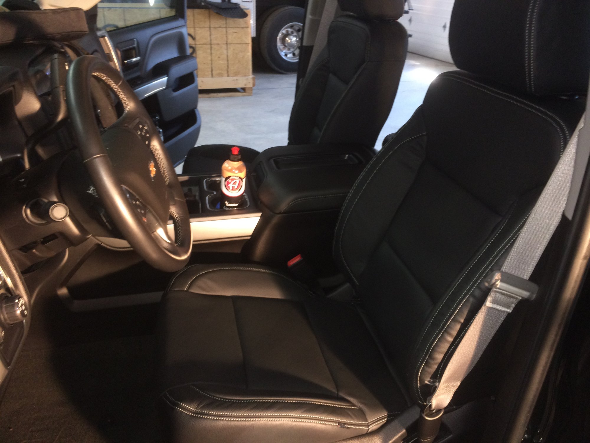

I had cloth seats in my '16 Silverado and did the katskinz off of eBay and installed them myself. There are videos on YouTube on how to install the seats. Follow the videos and take your time and these can be easily installed by yourself and they look like the pros have done it. I've had people in my truck asking where I had leather seats added and when I told them I did it myself, they asked if I would do their vehicles. Took me approximately 8 hours to do the install so give yourself some time.

Just buy them off eBay for $550.
Then have a local upholstery shop install them . That's what I did on both my trucks. They charged me $450 to install . So for a grand each both my trucks have Katzkins.

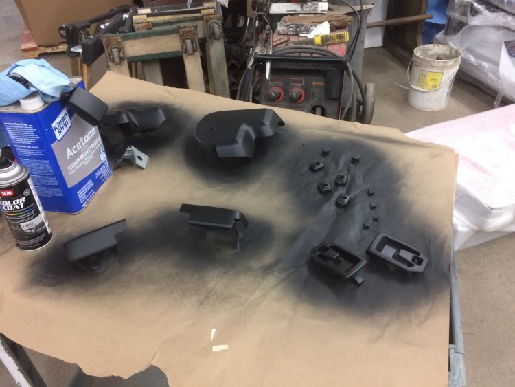

My seats are gray cloth but I want to switch to black leather.  How do I change the color of the gray plastic on the seats from gray to black?  Can they be painted with spray paint?

I did this with my '14 that had grey seats.SEM color coat paint in satin black is a perfect match,looks like it came from the factory.
clean all the parts really well with something like dawn detergent to get off any mold release or dirt.
Use their leather and plasic prep,it's an adhesion promotor (follow all the instructions)
Then paint with the color coat.I just traded my truck and mine still looked perfect after four years.

Those came out nice
