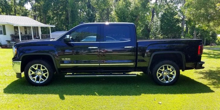

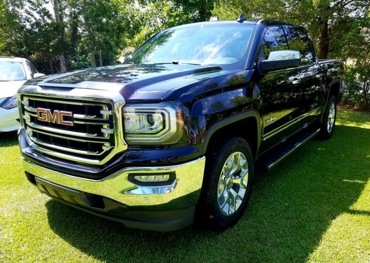

HELP! I just purchased a very nice 2018 K 1500 Sierra SLT (premium Plus trim). Problem is it had/ has flood damage. So far the only think that does not work is the power seats. Other than that the truck is clean and operational. I purchased the seat frame with all three motors from GMC and am ready to get to it. But... driver's seat is stuck low, full back and full reclined. No way to get to the two T50 hold down bolts in the back. I jumped 12VDC to the seat bottom tilt and height motors. The tilt motor works (it sits above the water line) but the height motor is dead. It sits lower (below water line) and is obviously corroded. I can not get to the fwd-aft motor or plug, but can see it shows signs if corrosion.  Any clever thoughts on how to get the seat out?
Thanks, Jim

So far so good. Everything except the front power seats work fine. The water just got up to the lower two seat motors not to the dash or console. Yes, a good deal. $56k truck with 7,000 miles for
$19 K. Total cost to make operational $370 for a new lower seat frame complete with motors. Just a pain in the butt to get the old seat out if you can't move the seat forward to expose the hold down bolts.
