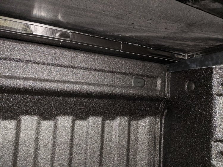

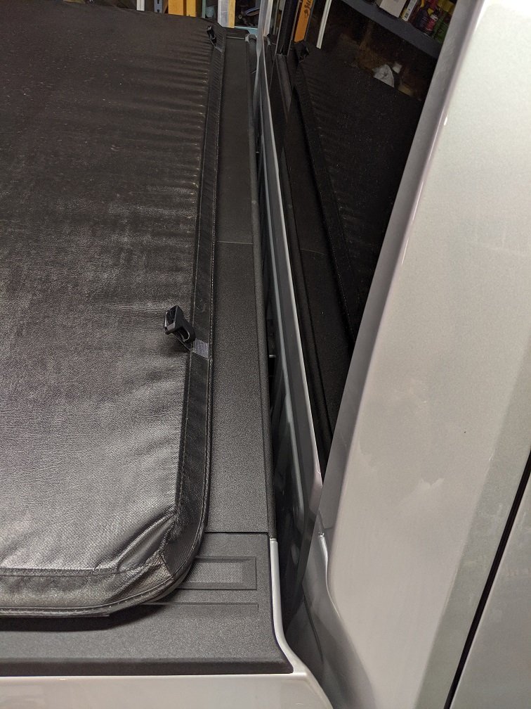

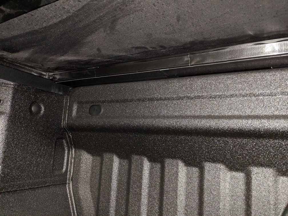

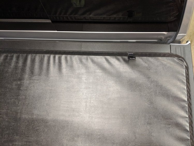

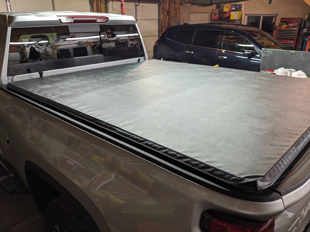

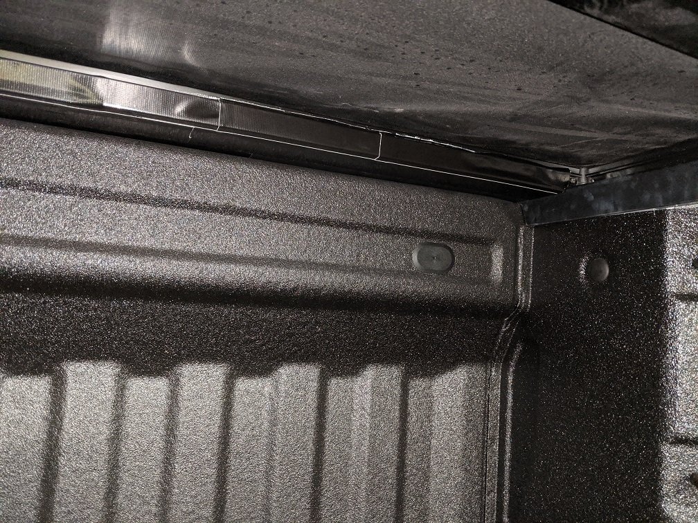

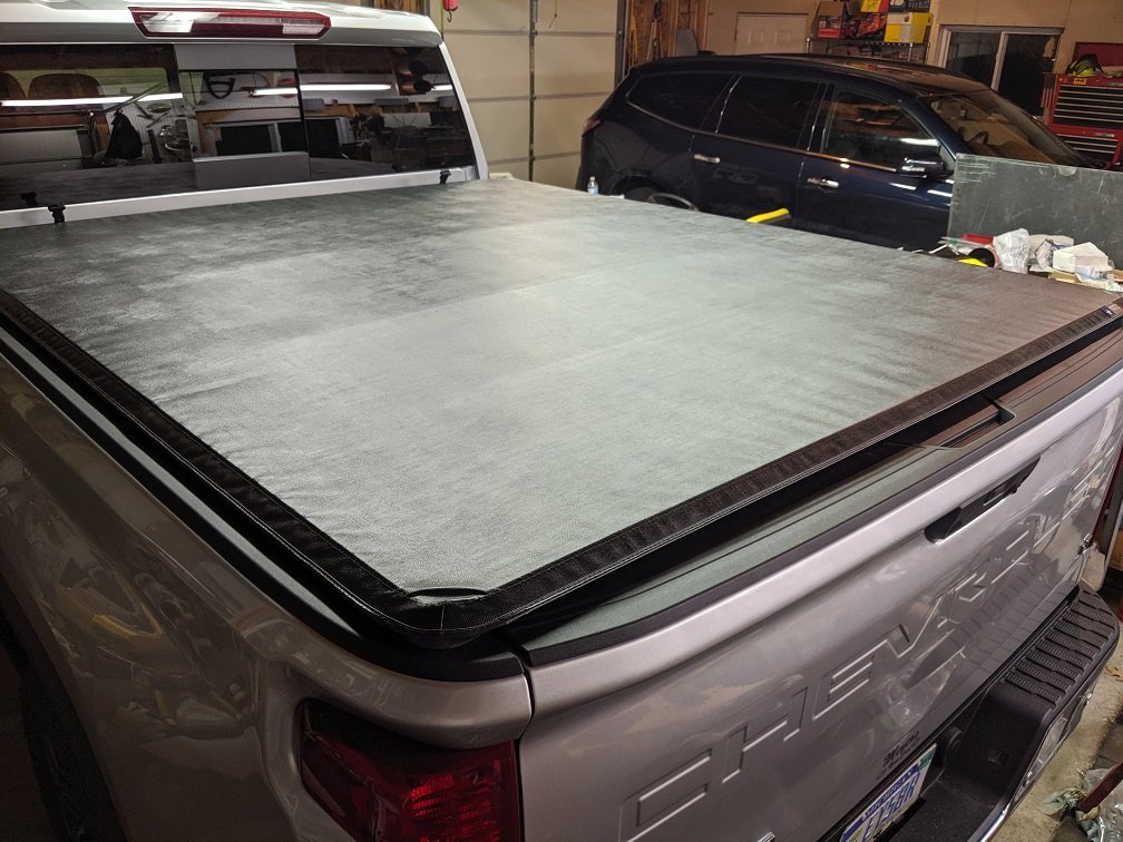

I finally got my gap filler piece made for my tonneau cover that is designed for a 2014-2018 6'6" bed. I was able to get some scrap semi truck mud flaps and cut them to fit what I needed with 3 separate pieces taped together to test it out. I used some black Gorilla Tape which holds really well. It turned out really nice for a test fit without any foam gasket yet. My filler piece is 4.5" X 63.875" wide to sit down between the bed rail plastic caps.
I will most likely be ordering a fiberglass topper in the future just like we have had on our previous trucks. Just works for us on family trips.
Inside the filler is taped to the front rail.
The texture of the mud flaps matches the side rail caps pretty good.
