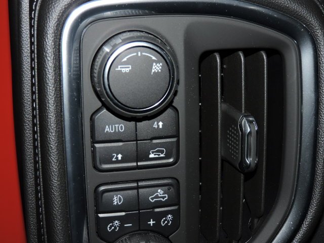

I believe that the Z71 option w/2 spd transfer case is not compatible with RST builds which instead come standard with 4 driving mode (touring, trailer, sport and off road) operation.
Sport mode (checkered flag icon) does not emulate 4Lo, merely adjusts shift points upward. RSTs, stock with a single speed transfer case and 4 driving mode option, have an Off Road button replacing the 4Lo button. The Off Road (lower right) button will simulate the speed/gearing of 4Lo position in the two speed transfer case; but, without the same amount of torque.
