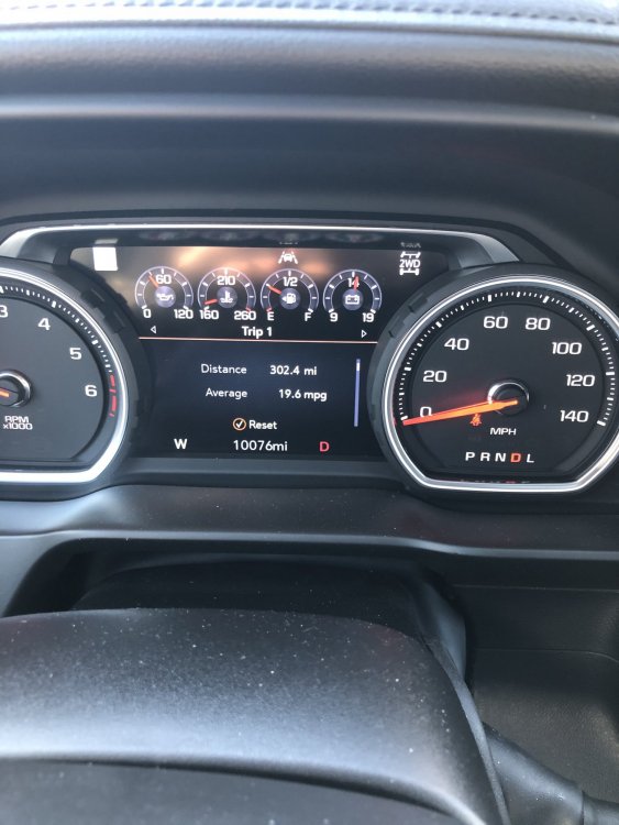

This was my best long trip, at or around 80mph for most of it. If you can keep it at 70 instead, 22 MPG is doable.

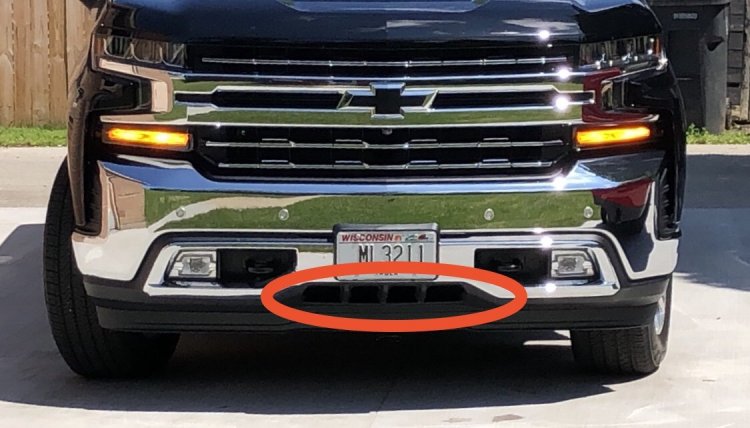

All of the 6.2 trucks have the 9.76” rear end, but the 5.3 trucks with the max trailering package do get the 9.76” locking rear diff over the standard 9.5”. Also includes:
-220 amp alternator
-”enhanced cooling”...a part of which comes from vents cut into the lower bumper valence (circled in pic below, 2.7T trucks also get this for the intercooler)...
-Trailer brake controller (often comes in other packages too though).
