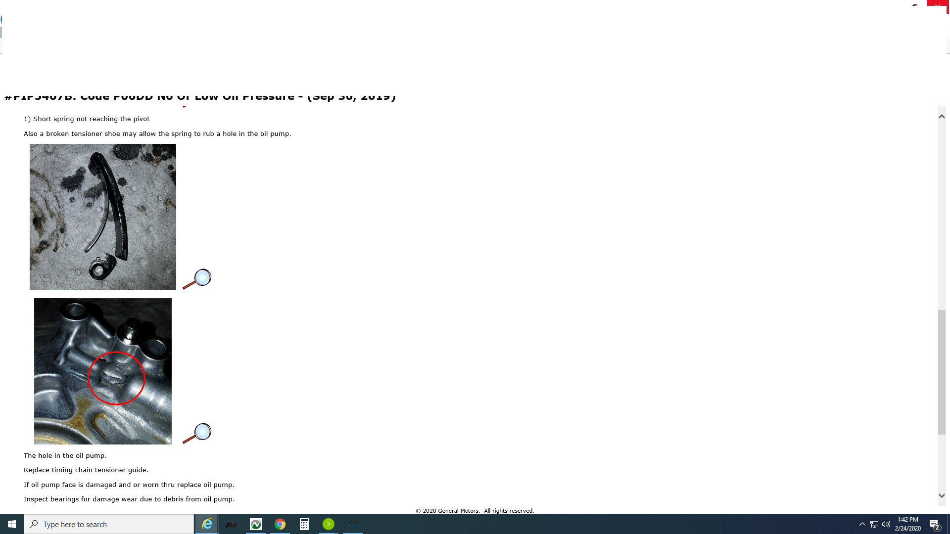

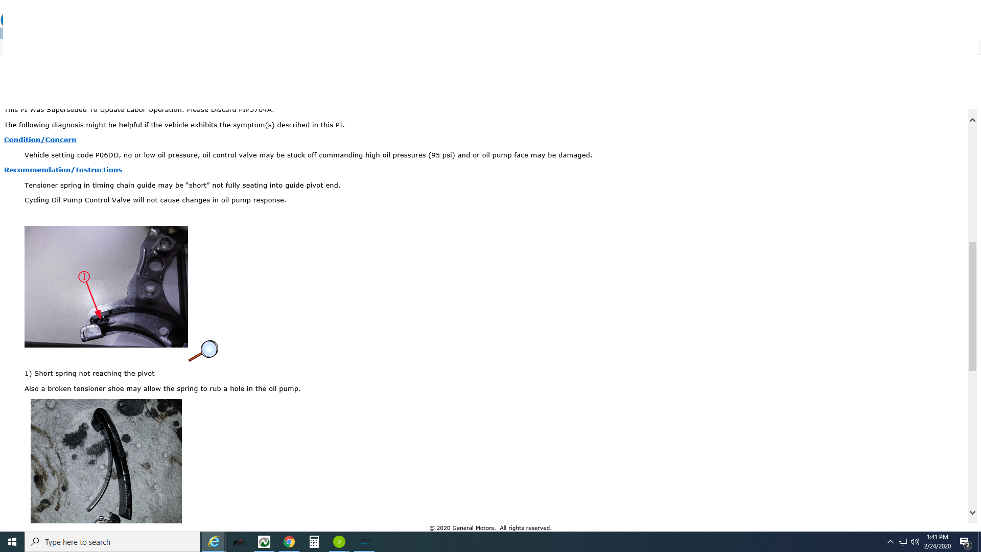

So I drove my 2014 Crew Cab (5.3) down to Florida from NY. About 300 miles before my destination the check engine light came on, and the oil pressure shot up to 60Ibs at idle..I got it scanned and it came back with a oil pressure sensor code. I cleared the code and continued driving to my destination, while the pressure was steady at 40-60lbs @2k rpm. When I got in I left the truck at a Chevy dealer and they are telling me that my oil pump is shot, and it will cost me $2500 to get it replaced. Apparently the pump is a two stage pump and there's a spring that regulates if the pump is at low pressure or high pressure, and the tech believes that it broke and it's stuck at high pressure. My thing is that I've been driving the truck for a few days before dropping it at the dealer and the truck was fine, while the oil pressure kinda alternates, and I'm trying to decide if I can drive the truck back home and have my mechanic fix it instead. My guy said to me that as long as there is oil pressure and I don't push the truck, that it should be fine. I really don't want to have to fix it in the middle of my vacation either so I'm asking for your opinion. attached a few pics. Thanks in advance for any help provided.8b5a5c5512a8f73f1c2745ff1ef0e058.jpge4f26c76f47f7ec27834344bea37a31c.jpgf65aae4f0797ece44be8d0d7a4b52875.jpg

Yep needs oil pump. There’s a bulletin for the spring breaking. It defaults to max commanded when it’s broken so as long as you see some pressure you’ll be alright, however I wouldn’t risk it. If you’re on the interstate and it completely let’s go and you need a tow then you’ll be in a world of hurt.

Interesting. That's the first I've heard of this on our trucks. Is this an early model thing? Have they ever updated the pump and used a revised one? Because I notice the OP's is a 2014, first year of the new direct injected ecotec family.
Well, I bit the bullet and dropped the truck off at a GMC dealer this afternoon. I asked them to save the pump so I can take a look at it. I'll post updates
