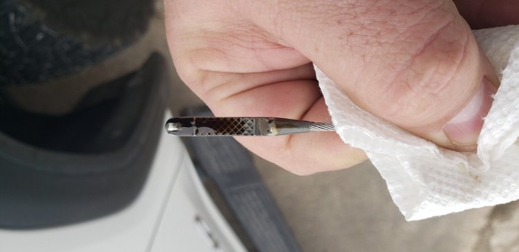

Another update.....Current mileage is 35,305. Oil life indicator is 52%. Last oil change was 31,778. Checked dipstick and it showed low..... see pic....added 1 quart, still showed low, added 1 more, now shows full. Total fuel consumption is about 464 gal so still well within GM's spec. Just the way it goes I guess!
  • Sad 1
I may be 'normal' for them to make them like this but....I'm not buying any as long as it is.
That's crazy and I'm sure very disheartening.  I know as ****** as I am about fluid levels and concerns with noises and everything else that that would drive me nuts.  Sorry that's happening to you.  I'm only at 5900 miles and it hasn't used a drop.  But I'm sure it could start in the future, not a good thought.  Have you thought about possibly trying a different oil?  I know I would for sure.
