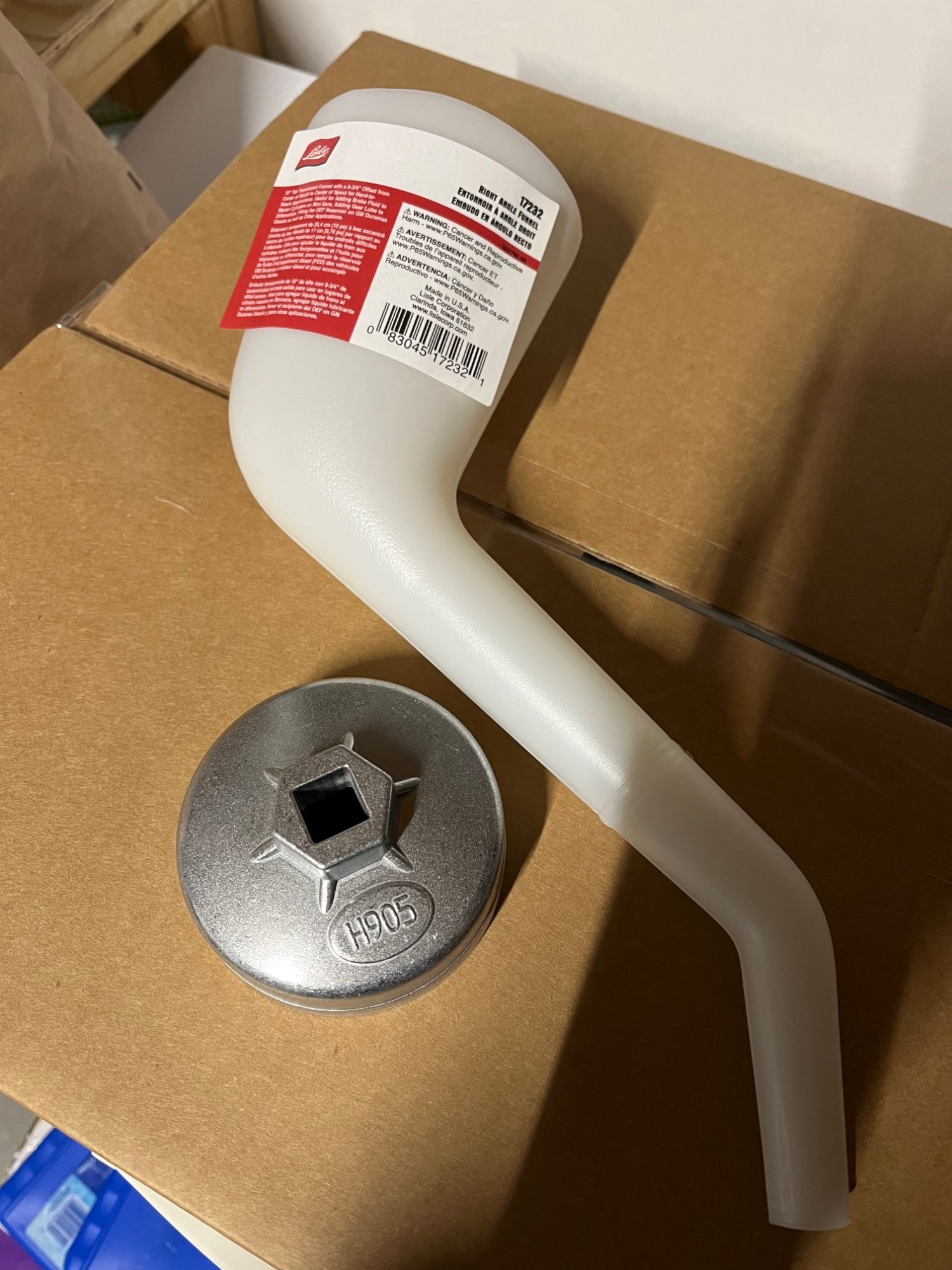

When I did mine I realized a straight funnel is not gonna cut it for this truck. The angle of the valve cover makes it very difficult with a straight funnel so I just picked this right angle one from lisle. This should make filling so much easier. Also picked up that filter wrench for 6 bucks. I go hand right but on occasion it’s nice to have a proper fitting filter wrench.
  • Thanks 1
Yes, thanks for the reminder about needing to get a long flexible or bent funnel of some type. I made do with a plain funnel and vinyl tubing I had around last time, but it was awkward and slow, and I need to get something better.

Yeah I used a flexible one I had too with a clear tube but like yours, it was so slow and took longer to fill the 8qts than drop the oil and filter. This lisle should be great and was amazed to see made in USA on it.
