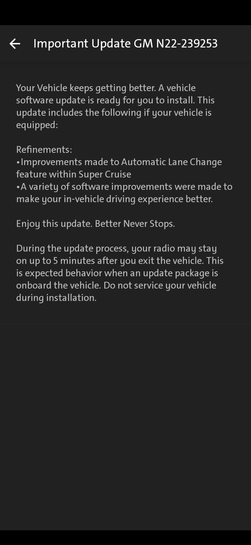

I've had my 23 Denali for three weeks now and the phone charger was absolutely terrible. I have a Pixel 7 Pro with the  case on it was almost impossible to find the sweet spot . It was better with the case off. Last week I downloaded a system update GM N22-239253. Ever since that update the charger has performed flawlessly anywhere on the pad as long as the  goes in top down That's even with the case on.
I just checked mine under updates and had nothing new, hadn't been checked since 3/9, mine is a AT4 diesel, not sure what your Denali is
Just a 5.3 Denali with the Reserve Package. No Super Cruise. This is what I took off my phone as to what the updated  enhanced.   I see your a trap shooter .Go out and break some Birds. I'd be getting ready break some skeet birds this morning but the club is closed for Easter weekend. Hang in there I'm sure the update will bet to you soon.
Im actually a skeet shooter also, 3 TN state titles in it. I still have no software update from GM, I wonder if it was a gas only update, or maybe a Denali only update, who knows, Im still using mine with the rubber pad off and its working pretty good.
