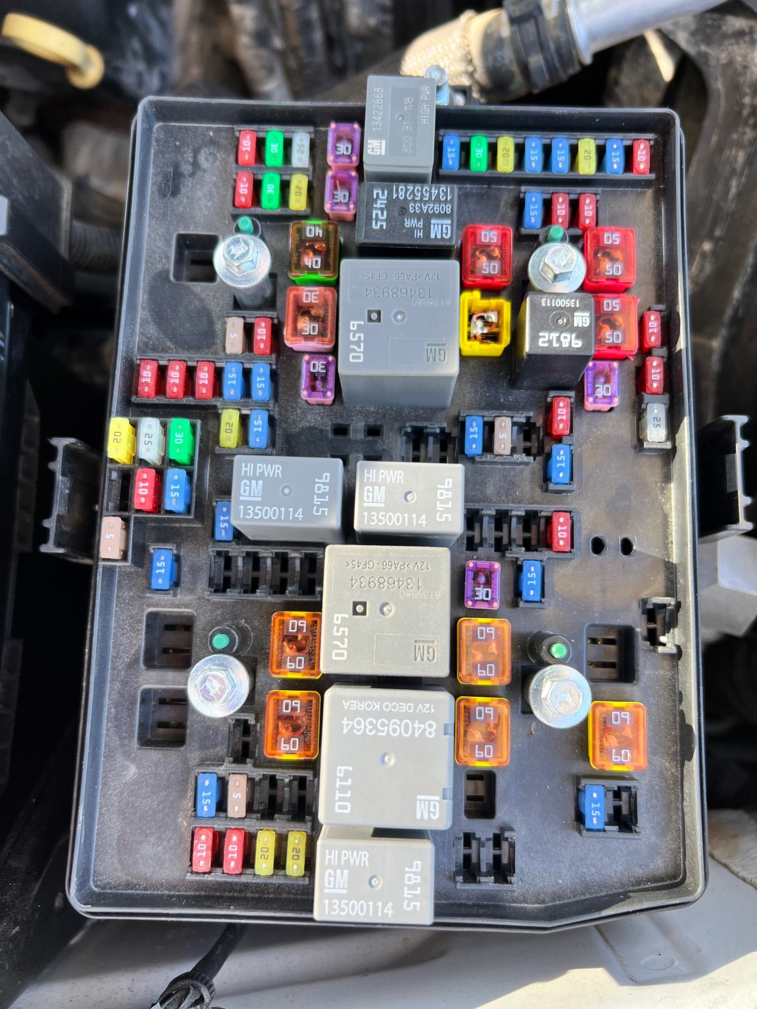

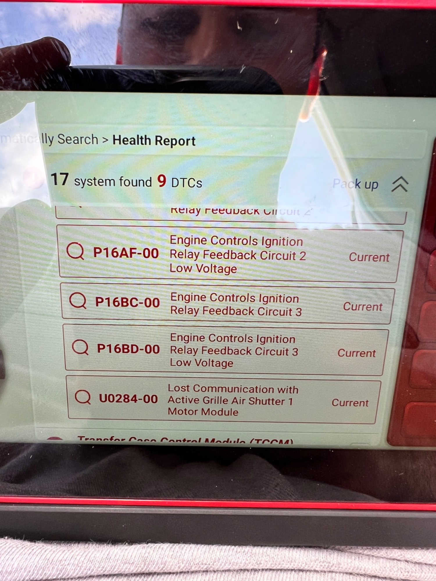

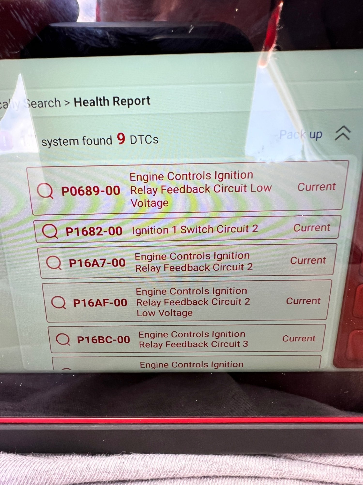

I scanned for codes and had 17 DTCs at first, once cleared, 9 DTCs remained with Ignition circuit issues. I went through all fuses and relays under the hood, driver side, and passenger side fuse boxes with multimeter and all tested good. Also tested relays with 12v power to each relay at pin 85 and 86 for an audible click. All tested good.
