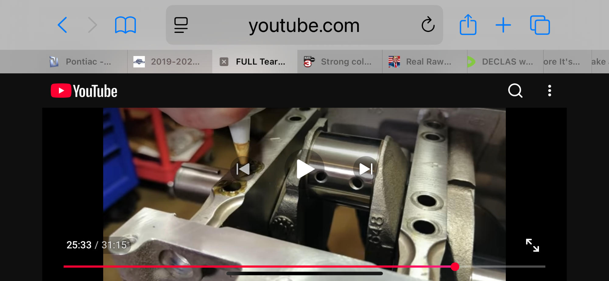

Not sure if I should thank you or not because, based on what they found in this video on both engines, this has me thinking ALL these engines are going to blow at some point, some just sooner than others. In other words, it looks like the journals and bearings are going to wear at an accelerated rate, and we will all experience the issue at some point, and GM is hoping that MOST of them will die AFTER the 150k mile obligation they settled on with the NHTSA. Your thoughts?
Expand
I believe you are correct. Those cranks suck. The chamfers are way too big. Roughness is bad but, how many cranks are worse than that on the many rebuilds that many bring to everyday machine shops? Stock rebuilds, hot rods, etc. Most to all seem to last anyway.
Im with ya.
13 minutes ago, customboss said:
Not a player. 9 cSt vs 11 cSt @ 100c won’t save a rough crank.
Thinner oils need a smoother surface. There are a lot of rough cranks out there lasting. But, yes, you are correct.
  • Thanks 1
Looked like a handful of sugar sand on the bottom of the pan.
Both of the engines they took apart had failed the pico test. I would like to see one that passed taken apart.
Me, too!
