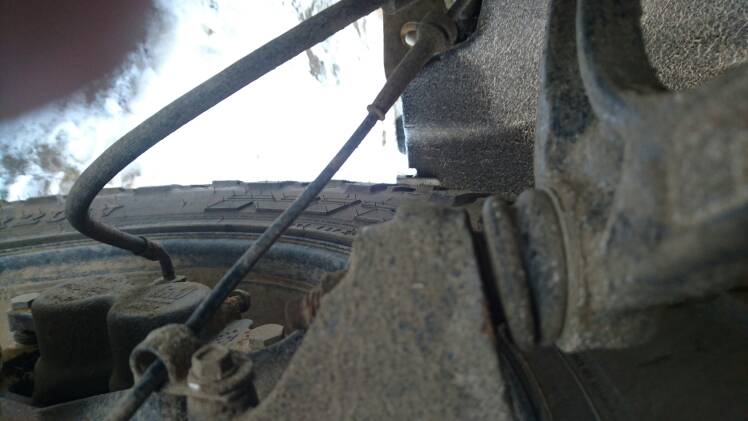

Will someone with a Zone 6.5" lift and aluminum control arms please post a pic of your upper ball joint? Had my kit installed yesterday and the upper ball joints are not seating all the way. I am thinking they may have sent me the steering knuckles for the steel control arms even thought the box they were in was for the aluminum. Here is a pic of what the upper ball joint looks like.
Still curious if anyone else's upper ball joint looks like this with this lift. Would really appreciate it if someone could take a look or post a pic.
Looks normal I have steel arms but it looks the same. Bad pic post-146784-14585178377_thumb.jpg
Sent from my E6853 using Tapatalk
Well actually lookin at your pic again yours does look a little more out then mine
Yeah...hard to tell from your pic but it looks like yours may be seated all the way. I'm gonna call zone tomorrow just to verify. Thanks for looking I really appreciate it!
Sent from my SM-T710 using Tapatalk
Just to provide an update on this for anyone interested...I sent an email to Zone and they responded immediately. Here is what they said:
"Thanks for choosing Zone Offroad. This is normal and ok as long as you have threads going all the way through the nut on the underside. I hope this info helps."
