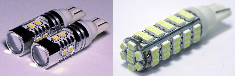

Looking at the housing, I think the major problems are the diffuser elements built into the plastic and the gaps b/w LEDs on bulbs. The diffuser scatters the light of the LED+lens on top of the bulb meant to project rearward. And the sides of the bulbs only emit light in four basic directions, so parts of the reflector don't receive direct light (left bulb in pic). This results in a zebra stripe effect out the back.
I'm thinking maybe a bulb with more LEDs covering it's surface might work better, though I'm not sure how bright they'd be (right bulb in pic). Dunno... I'm going to keep looking into this when I have time.
