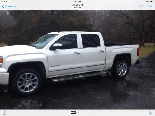

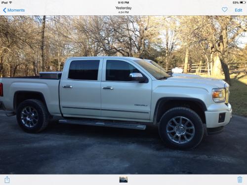

Pics? And is the ride rougher?
The ride is completely unchanged in my opinion. Nothing to be worried about whatsoever.
I don't have any great pics, really. This is the best I've got for you. Stock tires
